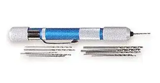

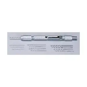

Although I'm not convinced a round hole of any size will give you the misting pattern you are looking for, micro-sized drill bits and an accompanying hand tool (pin-vise) are actually not that expensive, and will last you a long time (if not abused ;) ).
For ~$20 you can get a pin-vise and micro bits from many hobby shops (real or on-line).
Hobby Pin-vise and Bits
Alternatively, another (often cheaper) version of this is a drill-style welding tip cleaner:
Welding Tip Cleaner
They are REALLY good bits (they have to stand up to drilling carbon deposits out of the welding tips) and when sharp will go though PVC very easily. So easily that using a moto-tool (like a Dremel) may actually make the job more complicated and take longer in the end.
