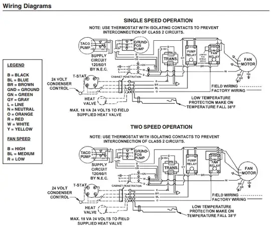

I found an installation manual for an Apollo Hydronic air handler that has a wiring diagram. The PDF of the Apollo installation manual is here and the wiring diagram is on page 8.

In the wiring diagram in the PDF you linked, the BR (brown) wire connected to the secondary side of the transformer would be your "C" wire. It connects inside the cabinet to the pump and fan relays, and comes out of the cabinet to the A/C condensor control (along with the "Y" wire from the thermostat).
