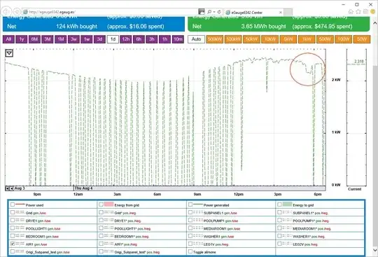

I have been experimenting with using an old mosquito misting system to mist around one of my AC condensers. It does seem to make a small difference in energy consumption and reduce register temperature by around 1 degree. Not much but enough to help when the system is running constantly when we have parties at the house. The red circle on the attached energy report for the condenser shows around a 100watt drop at 5:30pm when I ran the mister for 15 minutes. The system also shut down because the house reach target temp. What I don't understand is why ambient temperature makes such a big difference to energy used. The whole chart shows a wave as the ambient temperature changes from night to day. Oh, I use condensate from the indoor unit for the mister so it shouldn't contain calcium etc. AC Power Consumption
