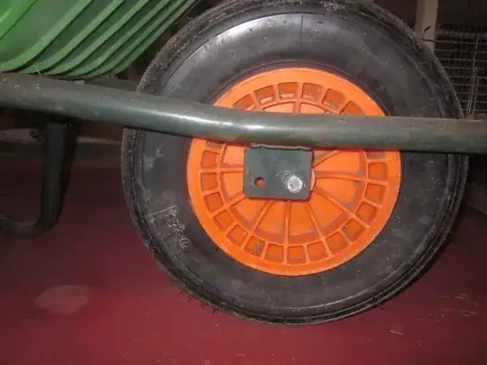

I have this wheelbarrow with tubeless tire, I had to replace it with the new one, however I don't see how to pump it! The tire is quite stiff, and it was tricky to put it on the rim, but now it looks like the tire isn't well adjusted to the rim. Did I do something wrong? How do people normally pump this type of tires?

Looks like the typical gap one gets when mounting a tubeless tire. You'll need to get the bead to seat against the rim as you pump air (hopefully quickly) into the tire - a hand pump might not do it.
Sometimes you can jiggle the tire to effect a temporary seal around the bead as your compressor dumps air in. Using a clip-on tire chuck will help.
Some folks "squeeze" the tire with a strap around the tread area. I've seen a device called a bead expander, and this guy shows the use of some large tie-wraps to achieve the same thing.

I've had decent luck using a couple of plastic bags and even saran wrap. I rolled them up and placed them near the rim so that it fills in the gap enough to get a better seal. The pump then works well enough to expand the tire.
The gap shown in the photo is small enough for this trick to work.

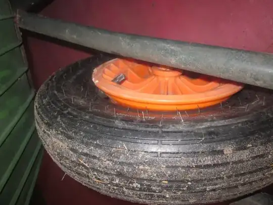

  1. Invert wheelbarrow
  2. Align the tire to the rim (as shown in the first photo, above)
  3. While adding air using an air compressor, give the tire a sharp rap with your fist
  4. Adjust tire to proper pressure
