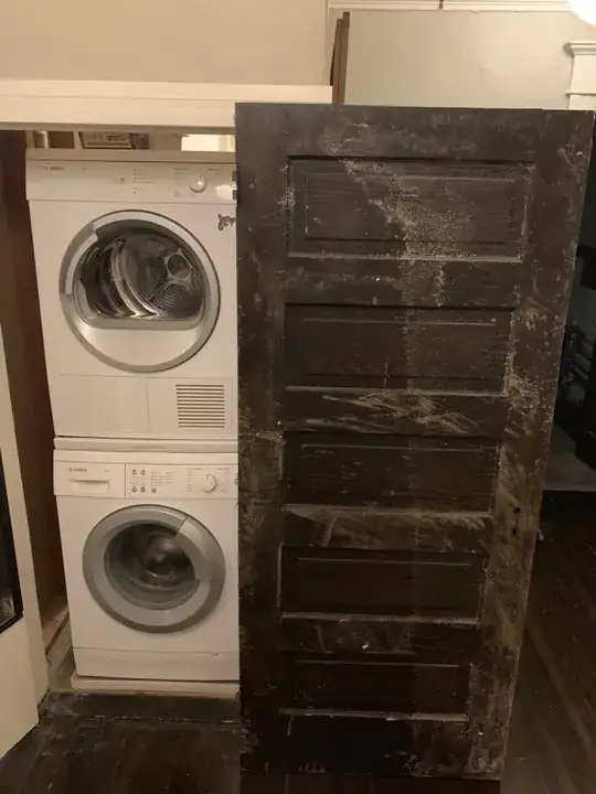

I've salvaged an old door from a neighbor's demolition to upgrade the door of my small laundry closet.
I thought it would be interesting to mount the door as a sliding barn door, both as a visual statement piece and to avoid constructing a new door frame/casing.

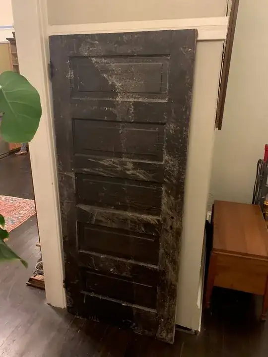

door closed
The issue is that the laundry area door/wall (cut into a solid wall cavity that originally housed a murphy bed) is only the width of the door. There is no door-sized wall to the left or right on which to slide the door when open, as is typical for barn doors.
So, when open, the door will need to slide into free space in the hallway.
door open

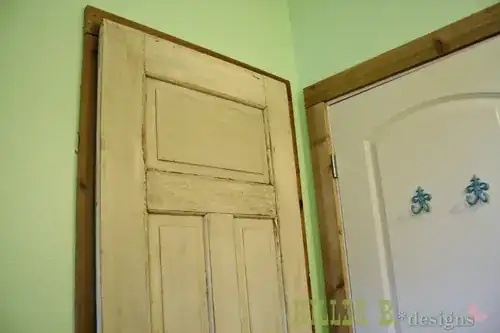

I happened onto this beautiful solid wood old door that just-so-happened to fit perfectly over the opening for our bathroom linen closet. I was thinking of ways I could mount it, with exposed hinges like our vintage pantry door and office closet door...
But there wasn’t really enough room to add a swinging door in the tight bathroom space. I decided it should slide, but what kind of hardware? Should I do the barn door track like the one in our old home?
Drawer slides! I know, weird right? But so far it totally works! Our door opening was 24.5″ wide, so I purchased heavy-duty full-extension side mount 24″ drawer slides. They’re rated to hold 100 pounds, which is twice the weight of this door. I cut a scrap cedar 2×2 board to fit in the lower part of the door opening and attached it with pocket holes and 3″ screws. Then I mounted the drawer slides to the front of the door opening at the top and bottom, and to the back of the door. It took a lot of fighting and fumbling with it to get it up, but I was able to all by myself!

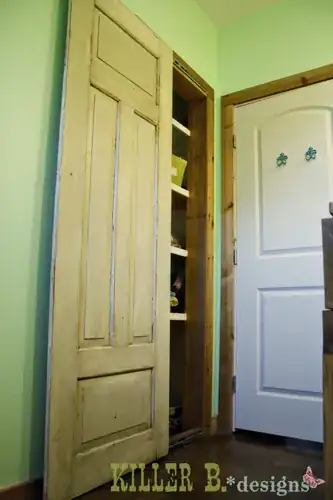

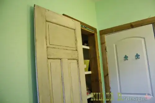

sliding drawer door
She does mention some issues with the drawer slides:
One thing I (and you, if you look closely at that top left corner) noticed is that it does sag if left open. I’m also concerned about the potential of it falling forward off the rails. I’m thinking about mounting a bracket on the top to keep it in place, and possibly a small castor on that lower left edge.
