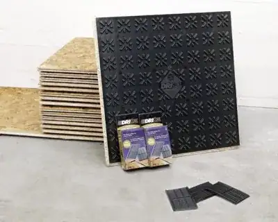

From a comfort and water protection perspective, I think you'll find it beneficial to install a sub floor. I'd recommend one which allows for ventilation beneath it such as these 2x2 panels you can buy at Home Depot/Lowes
Dricore
This will give you a nice, warm "softer" surface to put your carpet pad on, and help protect from any condensation issues with the cold floor beneath by allowing it a place to form, and then with the proper ventilation openings cut into the subfloor (standard floor vent in the carpet to allow airflow) it'll dry out on its own.

This sounds like a job for floor tiles. There are several brands, and two types. One has plastic feet, the other main style has foam (a popular brand is Dricore R+). The foam insulates more and is resistant to "clicking" if the floor is not level. The plastic feet type probably does a better job drying.
On top of this subfloor, you put whatever you want. A lightweight underlay and carpet that can breathe a bit, and you're good to go.
