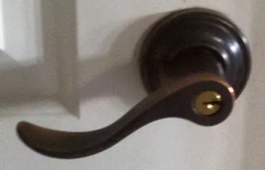

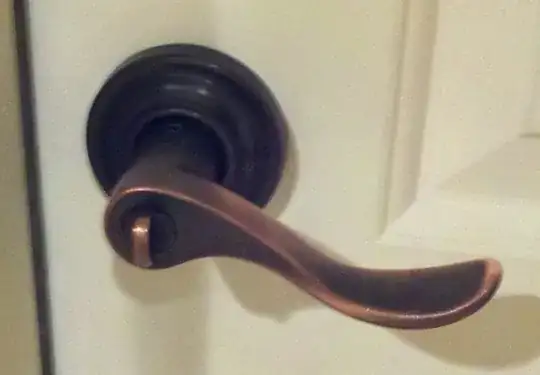

I have the following door handle / lock combination that leads out to my garage. The key for the door has long been lost and sometimes someone will turn the internal lock and the door cannot be opened from the garage side. I wish to disable this lock, how do I do that?

Glue could fail and/or look ugly. Other options cost money. When you remove the inside knob, you will see a connecting rod protruding from the latch mechanism that engages the lock button. Cut this off so it no longer engages the lock button. Do not cut the semi circular shaft that engages the main lever! Ensure the remaining stub is turned to the unlock position and reassemble the knob. The lock button will now turn freely, but it's impossible to lock the knob without a key or disassembling the knob.

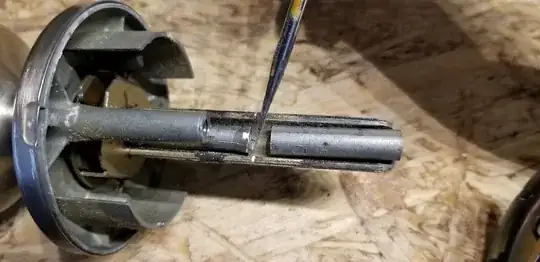

enter image description hereI had the same problem, different keys for the bolt lock and the knob. In the picture I show what I cut on my knob to keep it from ever locking. You may find that your center post looks more like a flat bar but it does the same thing and will need to be cut.
