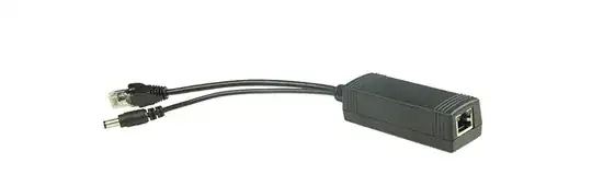

If you bought a porch light fitting that can run on 5V or 12V then it is possible to use a "POE splitter" which takes a POE-enabled UTP wire and extracts the power to a USB plug or a barrel plug and provides a RJ45 without POE to a computer.
Any light would have to be LED, with a maximum power draw of about 15W because that's about all normal POE can supply.
Downside, this would need a run of UTP cable to the light and a second run to the camera as well as a POE etherent switch in the house.
This would also obsolete the mains-AC power cable that goes to the porch light and you also would loose access to any wall switch to control the porch light. That may not be an issue if its a motion-sensor light and will stay active all the time, turning on the light when needed.
