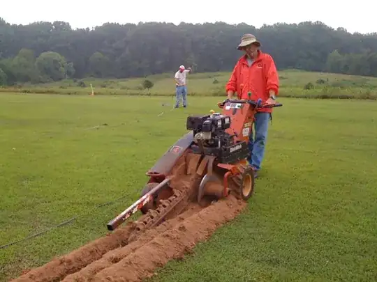

It's physically very difficult to dig a very narrow but deep trench. You may have better luck just renting a ditch digger/trencher, which is kind of like a big chainsaw for dirt. You can dig trenches that are very narrow, and the only thing that really slows you down with it is large rocks.
You should have utilities marked before you dig (whether using a trencher or not). In some areas, this is enforced by law (eg: in Ontario, Canada, it is law under the Ontario Occupational Health And Safety Act).

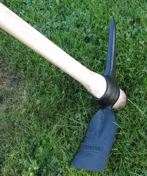

Speaking as one who has done this (or close - my clay was rather hard once you got into it, and it was a deeper and longer trench) I'd strongly suggest one of these; a mattock.
mattock picture from chillingtontoolsonline
Peel off your turf if any, put it aside, use the mattock to break out the clay, use your shovel to lift it over the side. Clear your feet a nice space in the bottom of the trench, and work in it (not DO NOT do this in deeper trenches where you could suffocate if the trench collapsed - in a 3 foot deep trench, you would at worst be inconvenienced for a while until you dug your legs back out.) Keep your standing area cleaned out and clear. You'll need to be somewhat wider than 6 inches to have a hope in heck of digging to 3 feet of depth, IME. You may be able to reach down that far with a long narrow shovel (which I'm assuming your drain spade is) but it's hard to actually DIG when you are that far away from the edge - the leverage is not good.
A small excavator would be much faster, but costly (I've done them that way too) - it's a perfectly reasonable job to do by hand if you'd like to do it that way, and tool rental does not have what you'd like at a price to make it favorable. To keep to the 6" width you'd pretty much have to find a trencher, IME - or you could use a post-hole digger, but that would be more inefficient than digging a wider trench you can work in, IME.
