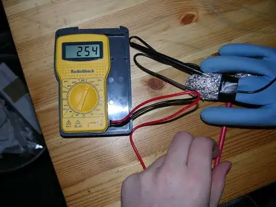

I would recommend looking at the tutorial from SparkFun: How To Use a Multimeter.
It is a bit specific to the multimeter that they sell.
Multimeter reading voltage

The first source of information is the manual that comes with the meter. Most have a section on applications that explain the use of the various functions (voltage, current, resistance) in everyday repair situations. Your local library will also have a selection of books on electricity for homeowners that will have chapters on using a multimeter.
Barry
  • 1,535
Since you have a Radio Shack Meter try their "Make Electronics" book.
