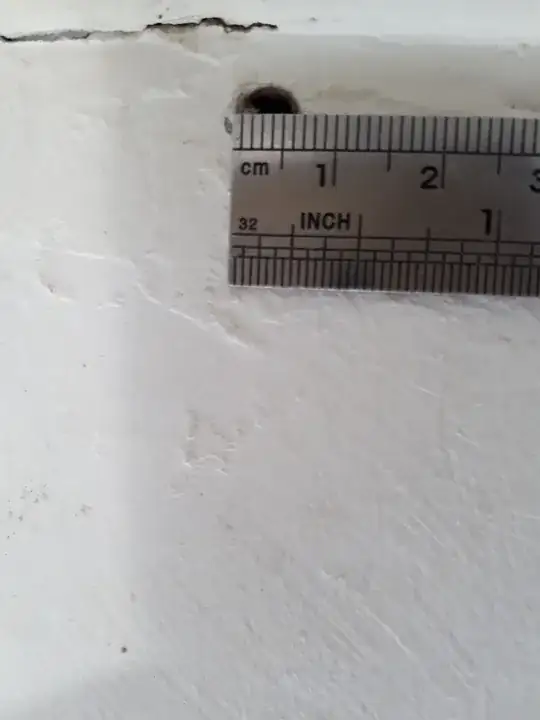

Here is the image of the drilled hole o the wall: drilled hole

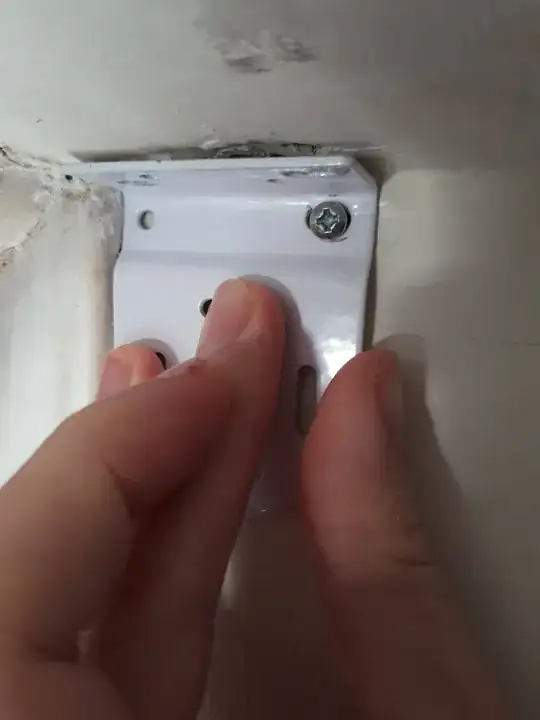

Here is the image of the screw with the window blind holder:final result
How do I fit the screw tightly and safely on the large drilled hole on wall?

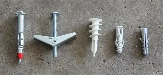

Here are some better designs of plasterboard anchor (drywall / sheet rock / gibralter board)
https://www.howtogeek.com/wp-content/uploads/2017/07/2017-07-26_0010.jpg
  • Rightmost is your standard cheap wall insert. It is supposed to flange out as the screw goes through the middle. Avoid where possible.
  • Second from right is a plastic toggle. These are pretty good because the two bits on the side fold and press against the inside of the plaster board. Ideally they should be sized for the thickness of your board.
  • Middle shows the large-radius coarse thread variant of the first one. These are astonishingly good. For double the radius you're getting at least four times the holding power.
  • Second from left is the toggle bolt. It needs a slightly bigger hole for the legs to go through, but when expanded inside the wall (as pictured, its got a spring) then there's a heap of holding area. Can hold medium sized mirrors.
  • Leftmost is a "mollybolt" and is an older design, harder to find. This one has four legs which fold out inside the wall when the screw is tightened. Note they do not adust for thickness - you need to size them for the thickness of the wallboard you're using. The pictured one is probably for half to 3/4 inch depth. A 1/4 inch or 6mm thick wallboard would have less shank on it.
Not pictured are the super-cheap tube ones that come with many cheap goods like smoke detectors. Not worth it at all.
Note, once installed, none of these plugs are going to come out without leaving a large hole.

If your hole is too large to take a wall plug or anchor, then your best solution is to fill the hole with filler (e.g. Polyfilla), leave it to fully harden, and then redrill the hole to the correct size. You don't need to worry too much about filling the hole perfectly flush - it'll be covered by the plate anyway.
Looking at your hole though, I suspect you may just want a larger diameter.
