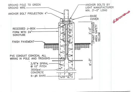

The standard for mounting a pole is 2' plus 1' for every increment of 10' of pole. That would mean your minimum depth would be 5' deep. That does not take into account the pole and fixtures EPA rating (which is a wind rating). I am guessing in your area the wind rating is somewhere around 70 to 80 mph. Most pole standard bases in commercial and retail parking areas are a minimum 6' deep and they are usually 8' deep. As far as a concrete pole pier this usually has to be worked out by a structural engineer familiar to you area. He specifies the pier circumference and the size of the rebar needed.
Here's an example for a 30' pole and fixture: enter image description here You probably don't need to raise the pier 3' above ground level, that's to prevent cars from running over it. Also you can see the hand written grounding note. You would need to install a ground rod and attach it to the metal pole with a #6 solid copper conductor.
