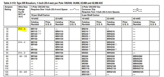

I am hooking up a disconnect for heating air unit. The instructions state use a 25 amp 2 pole breaker with 10-2 wire. The breaker says wire size 14-2. It is an Eaton BR225 beaker. Will it work with 10-2?

The Eaton catalog clearly says that the breaker can accept anything between and including #14 - #4 AWG.
Screenshot from Eaton Catalog showing acceptable wire sizes
You should follow the instructions that tell you to use #10, as it will fit the breaker, and will be appropriate for the amps you are running.

The breaker isn't saying it's for "14/2" Romex cable. It's saying the terminal is able to physically attach #14 through #2 wire.
Whereas the 14/2 cable designation means it has #14 wire and 2 conductors (in house cable ground is counted separately, in cordage it is not).
The ability to fit #14 or #12 is irrelevant to you, unless you are mounting the breaker inside the chassis of a piece of equipment that is not part of any building, or your wiring is being done in a very special set of circumstances unlikely to be seen outside an industrial setting.
