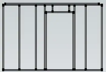

The wall is framed like this:

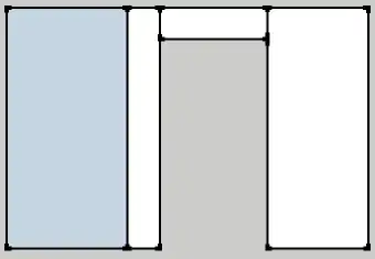

Option 1:

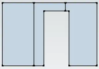

Option 2:

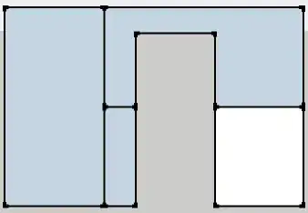

Option 3:
This last one may require some extra cripples at the ends of the header, as a nailing surface.

Option 1 is probably the best and 3 is the worst. Similar to drywall, you don't want a seam at the corner. This is where the load causes the most stress and therefore cracking.
For windows, it's the same. You install a full vertical piece as if the window isn't there, and make sure the seam isn't in the corner. Use a chalk line to mark the edges of the window frame, and then you cutout the window with a circular saw.
