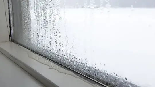

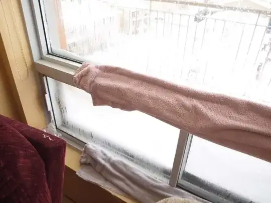

I will be leaving my leased condominium in Toronto, Canada for three weeks on 1 Feb. 2019. In cold weather, my window and balcony door sills have pools of water on the floor that sometimes pour into my hardwood floor, much more wringing than the pictures beneath. When I'm here, I sop them up myself. I don't have anyone who can come into my unit daily to soak up.
Towels don't feel that efficacious to me. Won't they stay water-logged?
