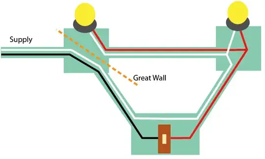

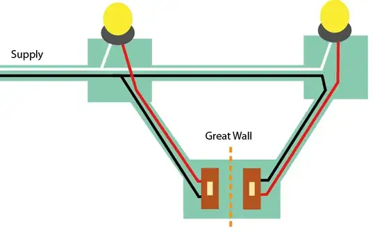

Note that colors signify function, even though the actual cable color is whatever standard cable colors are. Here, red is switched-hot, white is neutral.
You can't cross the streams - er, send current going in a loop. This is AC. It'll do bad things.
A basic rule is that currents must be equal in each cable or conduit. Think about an army of ants exploring a tree. Anywhere on the tree, if you count the number of ants that went up a branch, the same number will come back down. Currents are equal in tree topology - but branches can't touch. If an ant goes up one branch and comes down another, currents are not equal. Hence, circuits must be a rigid "tree" topology and loops must be prevented.
You see in the first drawing where there's a "Great Wall" separating the two switches.
So we do the following.
See how neutral goes a bit farther, but this avoids sending current in one direction around the triangle, and it is a tree (vine, anyway) not a loop.
**Notice how you will have two separate neutral splices in the left box. Don't combine them and don't mix them up!
