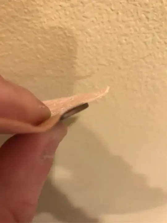

I am not sure why it says 8mm. It’s definitely not 8mm thick. It is less than 1mm. You can compensate for the thickness difference w/ a bit more of thinset. It is a membrane, not a board. At 8mm it would be impossible to fit in the corners.
update: i found a scrap piece of kerdi yesterday and a penny is a bit thicker than 3 layers of kerdi
kerdi and a penny
