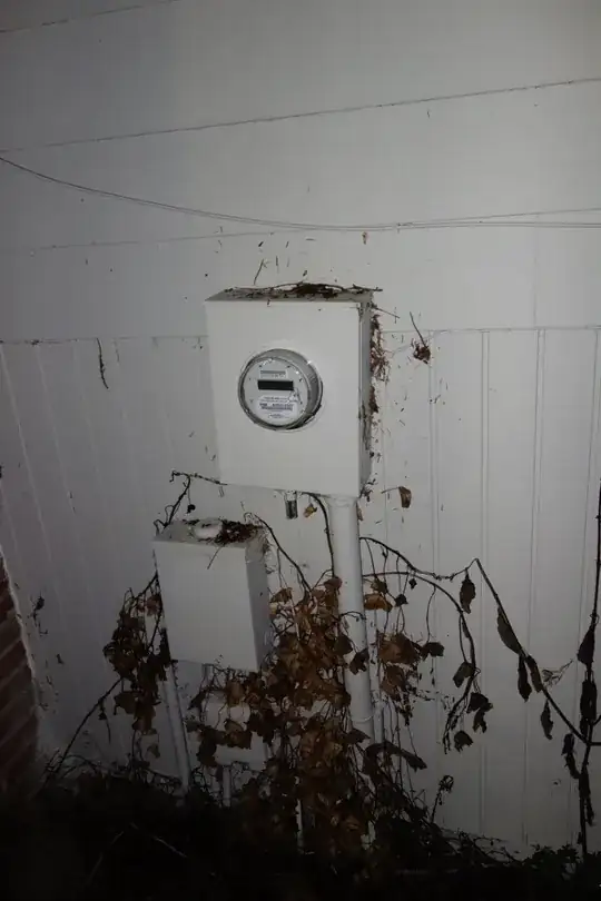

  • Current meter base.
    existing meter

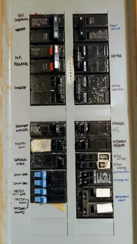

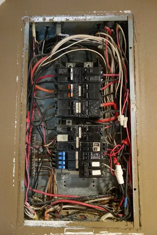

  • Current load center. The panel is exactly opposite the meter socket right now on the inside of the house. breaker detail existing panel 2 Breakers wiring detail

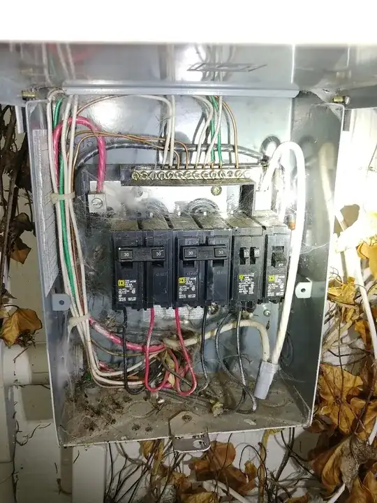

  • The Exterior Subpanel breaker is connected to this indoor-panel-mounted-outdoors-without-a-cover subpanel outside. enter image description here The first two 30A double pole breakers are hooked up to the water heater and the oven. The rest are unknown. I assume one goes to a sump pump; not sure where the other ones lead. I have some random outlets mounted to trees on my property from conduit that comes out of the ground; perhaps it's one of those.

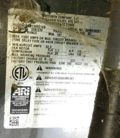

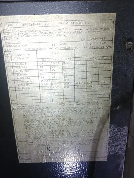

  • Central Heat Pump. Sorry for the spiderwebs: Central Air Handler Outdoor Unit

  • And the existing HVAC system, consisting of a 5 ton heat pump with a 32.3A outdoor unit and a 57A air handler/auxiliary heater. (We are assuming the basement heater is shut off for the purposes of this load calculation to simplify things.)

From there, we then add the HVAC loads for each space. The representative units I have chosen to provide an appropriately conservative load calculation are 18kBTU (1.5ton), 20 SEER, Mitsubishi inverter units that consume 12A at 230VAC, or 2760VA, apiece -- the real units used will likely be smaller still as modern building methods can produce vastly better envelope load performance than 500sf/ton. This is the largest motor load in the ADU, as well, which means that we must apply a 1.25 factor to it for ADU feeder sizing purposes, resulting in an additional 3450VA of ADU feeder load, an additional 2760VA of shop feeder load, and an additional 5520VA of service load.

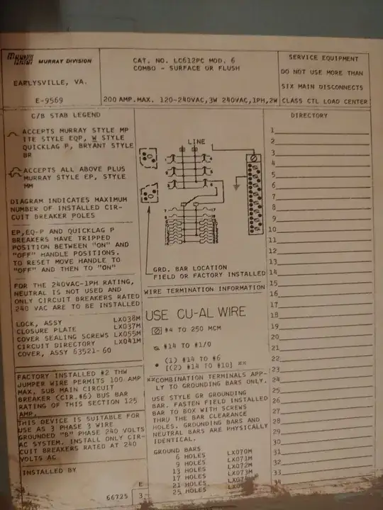

Either way, you will need to clean up your existing panels at this point. In the split-bus panel (a Murray, by the way), all the bare wires need to be moved to the left-hand bar (the ground bar), all the white wires need to be moved to the right-hand bar (the neutral bar), and the bonding screw that electrically connects the right-hand bar to the case needs to be removed. If the right-hand bar is not sitting on black plastic insulators, you will need to replace it with a Murray ECINSNB33 insulated neutral bar kit at this point, as well.
The small outdoor subpanel will need some more extensive work. Once you banish the cobwebs and debris from the cabinet, you will need to replace the interior trim (deadfront) with a Square-D 4055802102 (as per here and here), mounting the new trim piece using a Square-D 4020513001K fastener kit. While you are in there, you will need to fit a Square-D PK7GTA ground bar to the loadcenter, remove the bonding screw from the neutral bar, and move all the bare wires from the neutral bar to the new ground bar.
Alternatively, you could replace the subpanel with a brand-new HOM612L100RB with its bonding screw pulled and a PK7GTA ground bar fitted, reusing the existing breakers. This does require the extra labor of pulling the wires out of the old enclosure and swapping them over to the new enclosure, though.

It's the normal situation in most homes to have "just a meter" outside, and then have a short service cable from the meter to the main service panel inside. The service cable is completely unprotected, since it is upstream of the main breaker. Because of this, the allowable length and route of the cable is limited. For instance, people often have trouble when they want to move the main panel to the other side of the house.
Having an integerated meter pan and main panel is also seen often, but generally on low value "tenant/trailer park" tier units. These panels tend to be notoriously small in terms of panel spaces, and one thing we strongly recommend around here is an abundantly large panel.
Less often seen is a combination meter pan and main breaker panel, which is designed to have a very limited number of large breakers, each intended to feed a subpanel. To kind-of do the sort of thing you're talking about.
