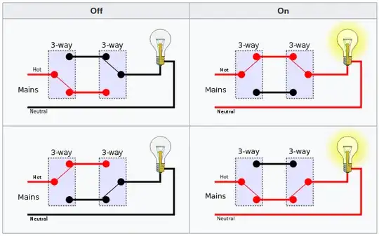

When there's two switches controlling the light, you use two three-way switches. Flip either switch to toggle the lights. The switches are called three way switches because they have three terminals to attach wires, not because there are three switches in the circuit. (Technically a three-way switch is a single pole double throw switch (SPDT) switch but again that term isn't really used in building wiring in North America. Everyone just calls them three-way switches.)
two switches
The wires between the two three-way switches are referred to as "travelers" and the other wire is referred to as the "common." The diagram shows the logical arrangement of the source power, the switches, and the load. The physical routing of the wiring may be much different depending how things are laid out. There are also some special purpose three way circuits that are wired a little differently.

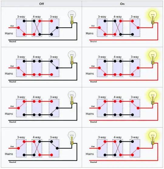

When there's three or more switches controlling the light, you use two three way switches and one or more four way switches. Four way switches have four terminals. A four way switch is a variant of a double pole double throw (DPDT) switch, but again that's not really important.
three switches
Note that you can have as many four-way switches as you want between the two three-ways at the ends. You don't use five-way switches for four lights. The position of the terminals on the switches also varies - you have to check the instructions or markings on the switch to determine how the travelers are connected.

This is how multiway switching works.
These are US friendly colors (regardless, colors tend to be a big mess in multiway circuits). Note the funny switch in the middle; it is different from the switches on the ends. The diagram may be a little unclear, the switch in the middle has 2 positions, either straight-thru or effectively switching the wires.
There can be any number of middle switches. Each middle switch either reverses/exchanges the two wires, or sends them straight through. All wires are always connected.
So yes, a middle switch in a 3+ switch run will be weirder than the end switches.

The first method is the simplest to understand. The permanent live is fed into the common terminal of one switch. The light is fed from the common terminal of the other switch. The other terminals of the switches are joined together by the "travelers". When both switches are switched to the same traveler the light is on, when they are switched to different travelers the light is off.
The second method connects all three terminals on one switch to the corresponding terminals on the other switch. One of the non-common terminals is connected to the permanent live while the other feeds the light. When both switches are switched to the incoming live or both are switched to the light then the light is off, when one switch is switched to the incoming live and the other is switched to the light then the light is on.
The third method is to use the switches to switch between live and neutral. The light is connected between the commons of the switches and then the other terminals of the switches are connected to live and neutral. When the light gets two lives or two neutrals it is off, when it gets one live and one neutral it is on. This method is NOT recommended because it can leave the light "off but live" and because it can cause shorts if the switches do not reliably "break before make". As such this method is not recommended (and may well be against regulations, but I have no idea what the regulations are where you live so I can't give advice on that).
To extend the system to more than two locations an "intermediate" switch is needed. This swaps over the two non-common terminals, so the light is on when it would otherwise be on and vice-versa. It can be used to extend any of the schemes mentioned above (though as-before the third scheme is not recommended).
