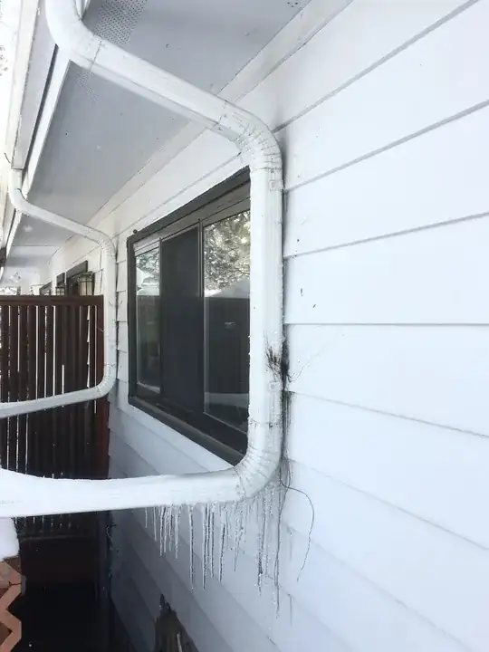

I have a downspout leading to a large rain barrel that leaks from one or more of the joints.
Instructions I can find on the internet suggest either taking it apart and re-assembling with new sealant, or scraping out the old sealant and putting in new, which may amount to the same thing given the access I have around the joints.
I'd prefer to fix the leaks without taking it apart. Is this possible? For example, is there some kind of tape or wrap I could apply?
It's in the back yard, so appearance is mostly irrelevant.
Photo of the situation. Notes:
  1. I'll do the repair once it warms up and dries out.
  2. The leaks are present in warm weather too.
Reid
  • 440
Downspouts aren't sealed because gravity prevents much water from coming back up through the lapped connections. So if that's happening something's usually plugged.
In this case, it's because of the ice blockage. If you were to seal the system you'd just move the "leak" to the gutter, and your icicles would form there instead because the entire pipe would be full of ice.
Eliminate the ice plug at the bottom and be happy.
Horizontal drainage needs a slope to drain even with threaded , glued or slip fit pipe like you have. With normal drain lines we look for 1/4 bubble to make sure it "goes down the drain". your slip fit down spouts are not a sealed joint. and no slope so even if you seal the joint next big freeze may split the "down spouts" because they look to be horizontal.

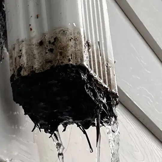

Sooo ... I finally got in there and indeed it was clogged. There was about 4–5 feet of this.
disgusting brown plug of goo emerging from a gutter downspout
