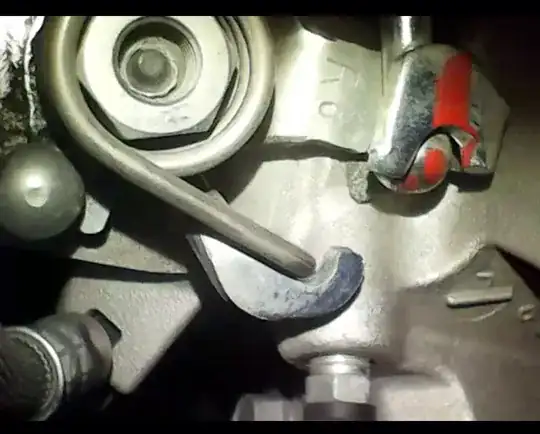

Here's a saved photo showing a small pebble caught in the handbrake caliper on my other half's car rear wheel. This was done by pointing camera behind wheel and using a pocket torch to light the area.
Own work
Grey rock is just right of center, below the ball fitting and wedged between the main housing.
