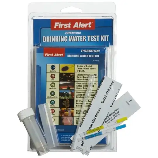

Beyond that, if you really have to know what's in the water, your only real solution to absolutely know with 100% certainty (technically, unless you watch the health department do the tests, and can verify their results, you can't KNOW that they're right...but I'd probably just accept it) is to get testing kits for this, that, and the other thing (that was just the first page offering a wide range of kits that I found), that operate similar to what you might use for pool water. Depending on the sensitivity levels, you may pick up on things like trace amounts of chlorine...but of course this is going to get back into the more expensive end of things, as those kits aren't cheap (Grainger's seem to run around $40-$50 and up...it's about $20 for their cheapest, which is testing for copper, on that first page of results).
You could pick up a pool test kit, which will cover a couple of parameters (chlorine, calcium, hardness, etc.), but it's not going to cover everything and may not operate in the range you need to identify your floaties...it's designed primarily to help you maintain clear-looking pool water that you're not drinking, not crystal clear tap water.

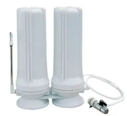

To remove excessive debris / silt / and dissolved chemicals
  • If you are happy that the water is not a hazard to your health and the only problem is some debris from pipes and or "charcoal??"(i think you mean carbon!) then installing a 2 stage filter on the main inlet of the house.. or at the tap that you intend to fill up on your drinking/cooking water.
The 2 stage filter consists of
1- 5Micron filter or spun polyster to remove particles such as silt / "flaoties" 2- Carbon block - removes smells and chlorine from water

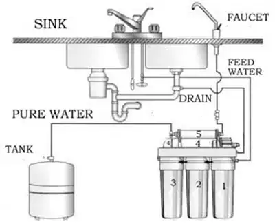

Commercial Solutions
If you star searching for designs like this- you will come accros manyu RO (Reverse Osmosis) filter that describe PURE drinking water. In my opinion and many others it is considered that drinking RO (reverse osmosis / distilled water) is not healthy! The other half will disagree- but they usually have some money to make out of it and these untis cost more than they should!
Interesting blog article. read about the water
A setup like this is used because RO filter takes absolute ages to filter water. removing the RO membrane allows normal flow.
A simple 2 stage filter should not cost you much and the filter media needs changin 6 months if used daily and about 12 months on occasion. It is important to note that none of the media releases toxins into the water once it is saturated.

You can use a simple drinking water test kit to prove to yourself that it's safe. Note, I have no personal experience with this since I trust the tests done by my municipality.
