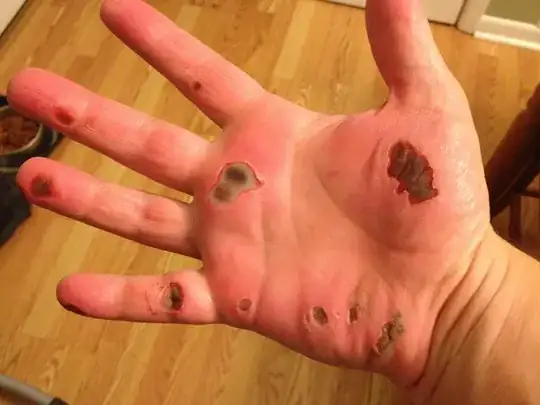

Wear gloves.
I made a similar mistake. My injuries aren't as severe as this guy but still similar in nature. I'm not sure if it's the abrasive action of the sand or the caustic affects of cement/lime, but likely a mixture of the two resulting in this mess. I started getting these injuries within 2-3 hours of working with cement/concrete. It's also extremely basic which sucks the oils right out of your skin which on its own has the potential to damage your skin.
Originally from reddit: enter image description here
