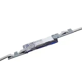

I'm sure this is going to be lambasted by the code gods, but is it SAFE to solder the wires in a Romex cable to extend it? Obviously I would ground the circuit as normal, just trying to avoid another junction box. Would I heat shrink each individual wire and then the outer sheathing as well? Thanks for any advice

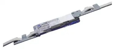

They do make Romex Splice Kits that claim to be legal for rework inside of a finished wall without junction boxes. Soldering is absolutely the wrong way, and regular wire nuts are not going to cut it. You need a mechanical fastener rated and tested for the job.

Well, they actually make an approved device to splice Romex outside a junction box.
