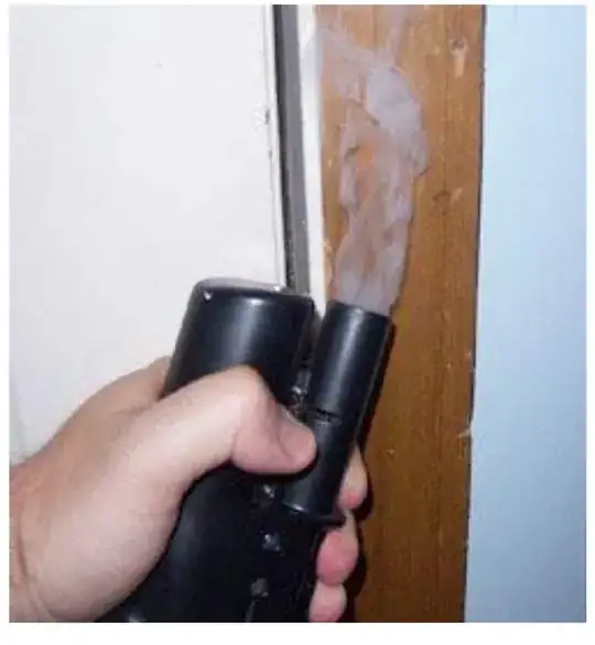

Use a smoke pencil
This is what pro hvac guys use to find drafts. it produces a thin stream of smoke that you can direct at the perimeter of the window. When you observe the smoke being drawn into a gap you will have isolated a leak.
