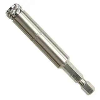

How the mechanism in screwdriver hold the hex bit? The specific part that I'm asking is the groove area in the bottom part of this image:
hex bit shank

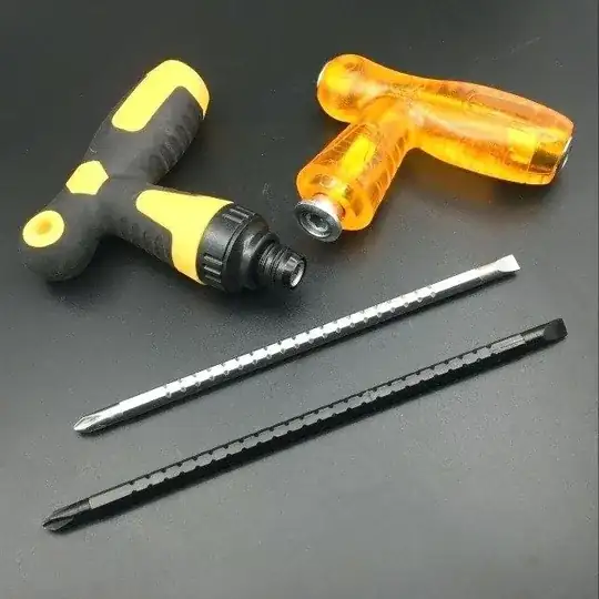

I have screwdriver like in this image:
T handle screwdriver

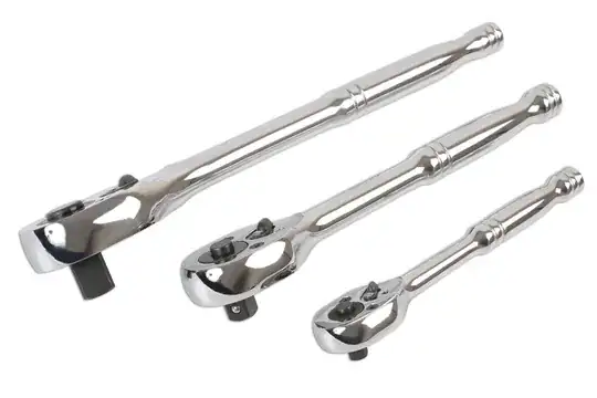

I'd like to know the mechanism inside the screwdriver to do this. I also want to know the history of why we stick with 1/4 inch size. While in the wrench, we had 1/4 inch, 3/8 inch, and 1/2 inch male square head:
wrench 1/4 3/8 1/2

The extendable bits you show with the small notches are only good in very low force situations. I have a driver with a bit like that and it never gets used because when I really need to press on a screw, the bit slips into the handle. The small notches are designed so that a metal ring can tighten around the shank in the grooves to hold the bit. The grooves are small, so it can only support so much weight.

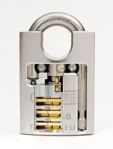

The larger round groove in the hex shank is made to hold the bit from slipping in or out and the deepness of the groove means it can support much more weight. The circular profile allows locking to be done with a thick ball bearing rather than a thin metal ring. Ball bearing locking mechanisms are found in many well made padlocks because of their simplicity and ability to resist very strong forces.
Ball bearing locking mechanism from LockLab

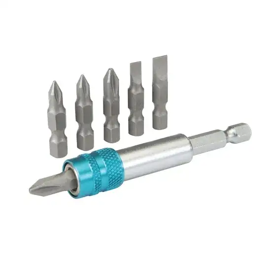

since your focus is on the 'groove at the bottom' of that driver bit... Those are for a "quick release" bit holder. Here is an example: enter image description here In this picture, the short 'driver bits' are meant to be pushed into the 'quick-release' holder. The driver bits snap into place and are held securely by some ball-bearings inside the blue collar, and to release the bit you must pull the blue collar backwards.
Of course you can use these "quick release bits" in any hex holder, but the purpose of the groove at the back is to hold them securely into a quick-release.
