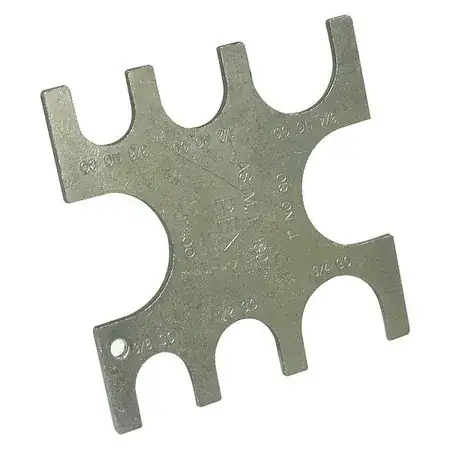

Here's a crimp calibration tool
www.zoro.com
It's used to calibrate the tool and to inspect crimped fittings after the fact. If you find an that the calibration tool doesn't fit over then you should re-crimp them.
