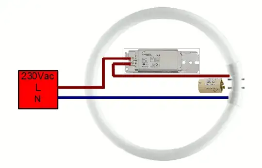

By the sound of things you must be using the older ballasts with a starter plug. These ballasts cause flickering of the bulb and this constant flickering causes damage to the ballast itself.
The ballast has to generate a very high voltage to "spark" the tube. Once the tube is glowing the ballast can relax and give a constant power output. The state between changing from high output to regulated is very stressful for the components and the starter plug is also responsible for handling this change.
