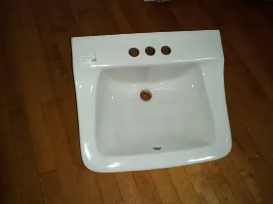

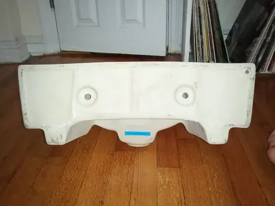

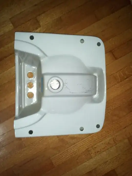

I'm replacing a sink that was on a vanity cabinet and hoping to do as little busting through the perfectly good tile as possible. I heard a rumor that I need to make very sure that the sink is adequately supported. I'm more than happy to add legs. I bought this Glacier Bay sink second hand so I've got no manufacturer's nothing. Also, I've never done this before.
Top View View from Below Rear View
If I can't find studs am I basically screwed? Can I build my own legs if I'm reasonably skilled? How would I go about that?

looks like it needs bolts with very large rubber washers/gromets. even then i'd be afraid that the weight of the sink would just crack the mounting holes. the mounting holes you've got are 300mm apart, exactly as stud distance. use a stud finder. i have a hanging sink but it came with hardware: two vertical metal straps that you attach to the studs, the metal straps lean out a bit at the top and the sink hooks onto those.

Use two lag bolts complete with rubber washers through the two holes shown on the last picture. In addition, you'll want to also install a wall bracket similar to this: enter image description here
Mount the bracket to the wall, screwing into the backing. The two tabs that stick out will allow carry the weight of the sink (the two leg bolts through the sink prevent the sink from tipping).

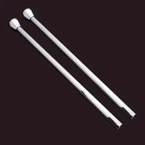

On the legs issue, you could fashion your own out of wood or pipe, but they need to be adjusted after the sink is hung to provide just a bit of lift. Difficult to get exact. Consider inexpensive premade legs such as these:
sink legs
SUPPLEMENT IN RESPONSE TO COMMENT: The legs do not go in the holes. You want a thin buffer, maybe plastic or rubber just under and aroung the holes, then a large washer (bigger than the holes) under that, then the head of the legs, which should adjust by being rotated up to abut the washer and rubber. If the legs seem to slip a little on the washer, try a bit of rubber/plastic between leg top and washer as well. The idea is to spread the contact area over more of the porcelain around the hole.
