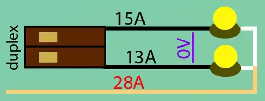

Absolutely not. That sort of thinking works with safety ground, which does not ever carry current, except during a fault condition (and we hope there aren't 2 independent fault conditions occurring at once).
However, current flows in loops. Neutral is the normal "return half" of the loop, and it needs to be dedicated to this circuit. In fact, neutrals don't have fuses and rely on the circuit breaker on the hot side to protect the neutral. You can't have two circuits sharing a neutral, or you get this!
But there's another problem. This is AC power. It reverses polarity 100/120 times a second, which throws electro-magnetic force into everything around the wires. That's why transformers work. To keep that from causing a lot of problems, we require that all the current that goes out one wire comes back on another in the same cable or conduit. Among the wires, currents are equal and opposite, so their electro-magnetic forces cancel each other out.
Now, borrowing a neutral means current is now making a big loop - "out" (really, it's AC) this circuit's "hot" wire and returning via another circuit's "neutral" wire. That will throw EMF on both circuits, causing all sorts of mischief - eddy current heating, wire vibration leading to noise and metal fatigue leading to cracking and spot heating, etc. Nope.
