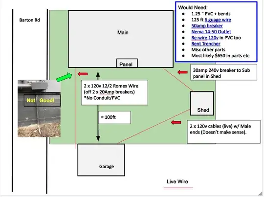

We have a detached garage approx 95ft away from the main house and we are looking to run a 240v circuit there.

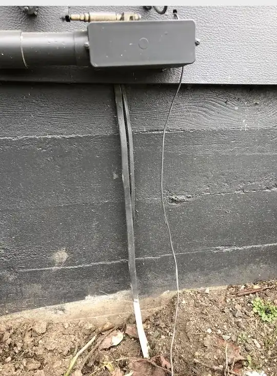

Currently we have Romex wire running straight into the ground. (This is how it was when we moved into the house. I have attached a picture below.) This feeds basic outlets and the garage door. We would like to run either straight to a circuit, or a small sub-panel to provide for the 110v (outlets and garage door, and 240v - EV)
My plan is the following:
  • Trench down 18" and run 1" PVC 40 Conduit to the garage
  • Insert a 70amp Breaker to feed the 60amp sub panel in the garage
  • Run 6/3 gauge wire from main panel in the PVC to the sub-panel in the garage
  • From the subpanel - just run the 12/2 wiring into the main circuit that is fitted up now (From the wiring that comes through the ground), Also run off the 50amp breaker from SP, the 6/3 wirirng to the Nema 14-50 outlet to plug in the EV.
The other option could be to avoid the subpanel and just run wiring to a an outlet.
  • Run a 50amp breaker & 6/3 wire + new 12/2 wiring through the garage
  • Connect the 6/3 to a 14-50 outlet and the 12/2 to the existing 110v setup.
Any tips, corrections or redirection would be appreciated.

When laying conduit, keep your bends to an absolute minimum between access points; use conduit bodies at corners to give easy access. You see a conduit body in your picture, but you can't use that one because service wires are in it.

Other stuff e.g. Your diagram
The weird cable with male ends on both ends is probably a "suicide cord" for running a generator. Or should I say a "murder cord" because his plan was to plug one end into a generator and the other end into the garage feed, to backfeed the garage then backfeed the house. And maybe he turns off his main breaker first and doesn't kill a lineman. (Because when a 120V generator backfeeds a 120/240-9600V poletop transformer, the voltage on the backside of the transformer is, guess what! 9600 volts. That's how transformers work.)
Even worse, it sounds like rather than running a 120/240V /3 cable, he was using two separate cables to backfeed each leg separately. What a hokey-dokey rig. This is what fools like that do. Just remove the plug ends at one end so nobody can plug it in.
On the remaining buried cables, you might dig 'em up for a closer look. If they are NM, tear 'em out - they are ruined. NM is not wet-rated. If they are UF, see how deep they're buried. If it's <24" it's too shallow, tear it out. Otherwise you can disconnect it, pull it through the building, slip a Sched. 80 PVC conduit over it and rebury it (at the bottom, an elbow of course), and then provide physical protection up to a proper Code building entrance. And then put them back in service. Free wire :)

Thank you again for all the input. Finally completed the job this weekend. Things I did in the end. Replaced a double 30amp breaker that ran to the hut, now runs to the garage. Ran UF-B 8/3 wire on a 40amp This is becuase the charger only runs max 32amp, so it made sense. We ran it through a conduit body, into the ground 18" all the way to the garage. We placed PVC 40 10" into the ground and into a conduit body. No wiring was exposed. We rand it to an outlet in the garage, and a 14-50 outlet that plugs into the car. Very happy with the outcome. My costs were the following 125ft Southwire 8/3 UF-B - $162 Trencher rental $61 14-50 outlet + faceplate - $11 Double gangway + spacer - $6 Clamps for panel/outlet - $5 PVC 40 1.25" - $5 Conduit body x 2 $8 40amp HOM breaker - $9 Total: $267.
