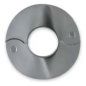

Do you have space to install a floor flange trim plate? These should be available in a variety of sizes, so you should be able to find one designed to fit around your pipe's OD. They are made from different materials and different shapes (plastic versions should be way cheaper than $10). It should look something like this:
steel floor flange trim plate
