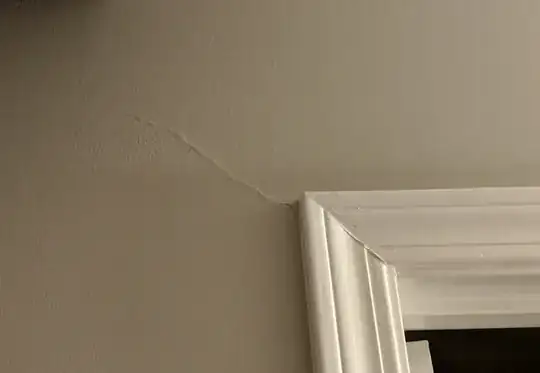

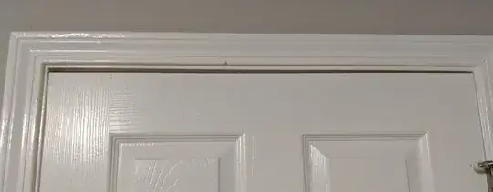

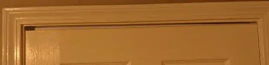

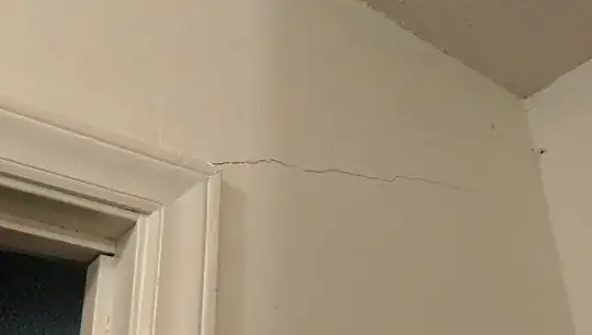

There are a few doors in the home that are slightly sagging on one side, maybe by 1/8th to 1/4th of an inch, and there are a couple of small cracks in the drywall extending from the corner of two doors -- one in my office closet, and one in the upstairs bedroom -- the bedroom on the same side/corner of my house as my office.

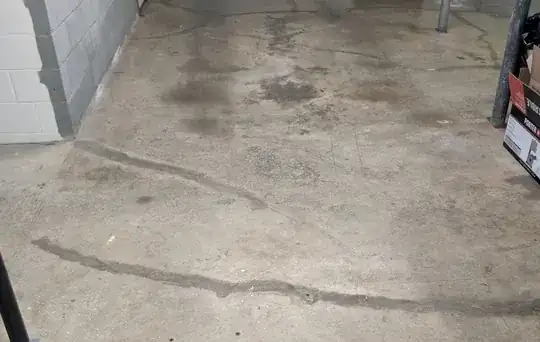

The slab in the basement has some cracking that has been repaired, and I know there was some minor water infiltration issues in the past, but they were fixed and the inspector found no evidence of recent water issues in the basement. It has been the wettest year in probably the past 10 where I live, so I feel like if the basement were going to leak, it would have done so already.

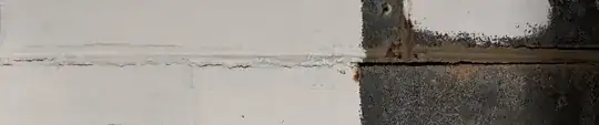

I've attached some images of the concerns I mentioned above -- I don't know what to do here. I'm extremely concerned because I just bought the place, so I have no equity to fall back on if I need an expensive foundation repair.
Should I start looking for a structural engineer, or am I being paranoid?

Update: So, I wanted to add an update here for anyone else who may have similar problems. I had a contractor with years of experience that I trust come in and look at everything. We discovered a couple things, firstly, at some point there was a load bearing wall in the basement that someone removed -- and replaced with a couple of inadequate and poorly-positioned posts. This caused the center of the house to sag slightly -- but the foundation seems okay. I got a few more posts, put them in better locations along the beam that runs along the center of the house, and I plan to eventually rebuild the wall that was there at one point. I likely won't try to jack anything back up -- because the contractor said that could cause things to crack more since it's settled how it is -- but it should be fine and stable now with the added support. As for the cracking in the cement wall -- we discovered it was three blocks -- not the whole wall, that are pushed in very slightly near/just under the ground line outside -- he suspected that our two very wet past winters resulted in water seeping into the ground, freezing, and pushing those block in a bit. He said that as long as I don't start having water come in there (which so far there has been none despite very heavy rains lately and a high water table), and they don't continue to push in, it's nothing to worry about.
