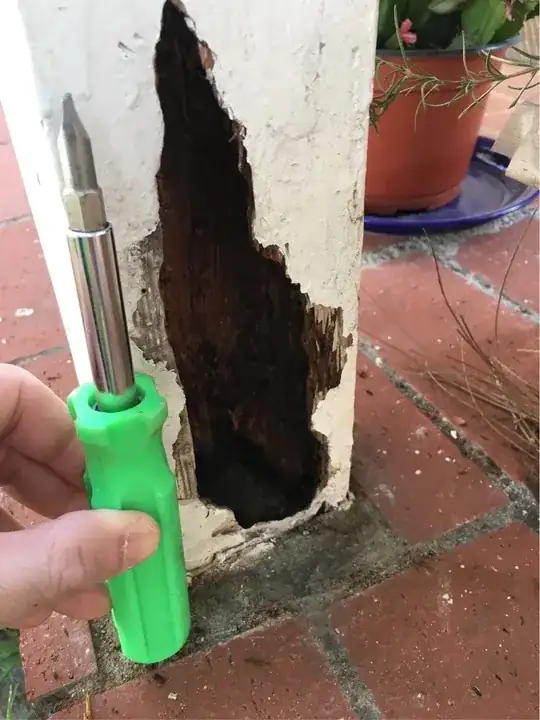

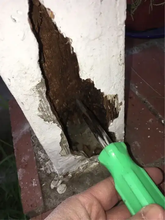

We’re getting ready to paint and I was checking around my porch. There are three columns that support the roof over my porch. One of them had a decorative cross member that was dislodged because of dry rot at the location where the cross member was nailed to the column. I saw some dry rot there and started to excavate the rot. rot dim 1 rot dim 2 rot dim 3 can see concrete columns base

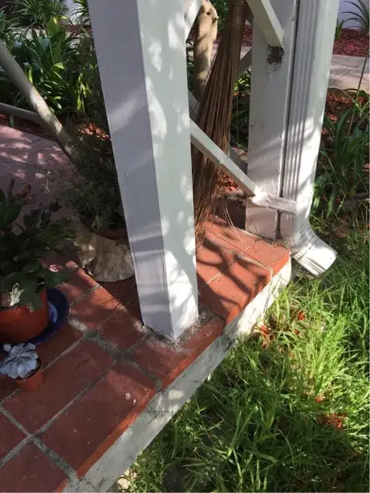

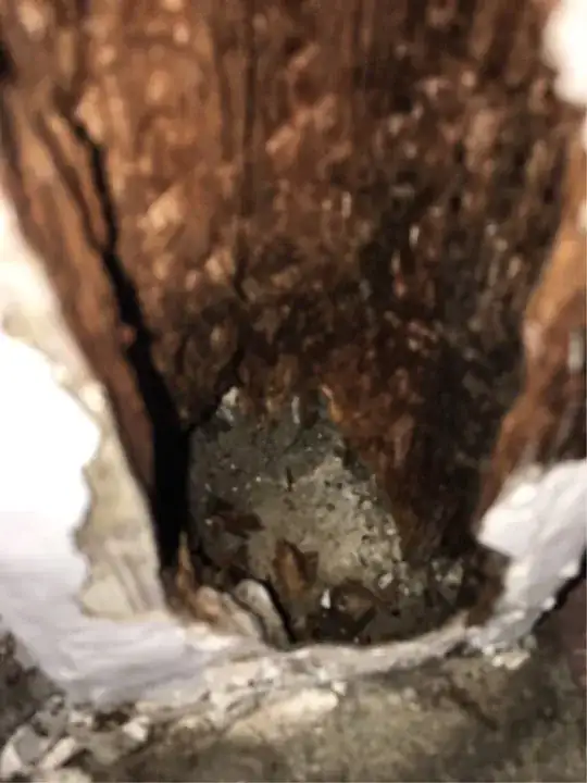

Here are some pictures of the bottom of the post. It has a small amount of concrete around the posts. The post goes into the concrete an inch or two deep.
What should I do about this. I think that since there are two others columns supporting the porch roof this one with the rotted base didn’t really affect the general load bearing aspect.
How should I fix this? Just add a lot of bondo, or wood filler, et.
Take the post out and put in a new one? (I don’t want to do this bc I would need to take out all he decorative cross beams.
Cut out the old wood base and graft on a nicer/new to replace the big sections that we cut out?

Are you sure about the load bearing? It may sag if you are not careful...
Anyway either replace the post completely or make a replacement bottom section and support the rest of the structure - acrow jacks work well for this type of thing.

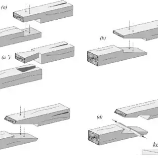

The post should really be replaced, at the least add a new bottom utilizing a structural splice
The issue with the structural splice, the new post section will not be the same dimension as the original, and will be quite noticeable. With a new post, it still may not be the same, but it will not be a noticeable as the splice.
Another way to do it is to either have a post custom cut to the size of the original.
Just a mention, it is wise to inspect the other posts at the very bottom. The post pictured since it is in the concrete a bit, the others will be too? The concern is the concrete or actually a course of brick pavers added after the posts were set, made a pocket to hold water which allowed the wood to rot most likely sooner rather than later.

Take as much of the rotten bits out. Soak/spray 2 or 3 times the inside with an epoxy slow hardening paint, let it harden pref a few days, fill up the hole with a slow polyester selfmixing anchoring cartridge and similar wood
If you want to see the wood and not polyester, use the same wood 45°routed on the front. Epoxy spray the parts that will be in contact with the resin. Covering the wood with epoxy spray is because the polyester resin will be soaked up into the wood leaving the filler not to spec.
