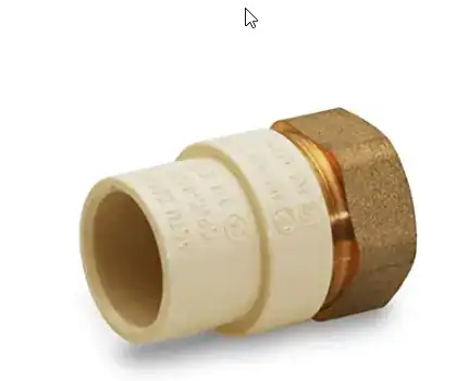

Does the Uniform Plumbing Code (US) allow copper-to-CPVC transition fittings to be used inside a wall? Just to be clear, I'm referring to the hybrid fittings that are part brass, part CPVC.
Copper-to-CPVC transition fitting

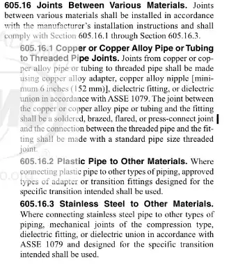

The code does not specify specifically that such joints cannot be inside of a wall.
UPC code section 605
