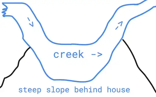

Behind my house there is a very steep bank/slope that leads down to a decent-sized, slow moving creek about 10 - 12 ft wide. Unfortunately it meanders right behind my property at the base of this steep embankment:
When we bought our house almost ten years ago, it had not meandered nearly as much and we had significantly more embankment/real estate than we do now. Over the last decade the creek has cut deeper and deeper into the embankment and we now have lost about 8 - 10 feet of property at the top of the slope due to erosion of the embankment. We are now about to lose our fence which runs along the top of the embankment and I think this is finally the year that I need to do something to stop the erosion of loss of real estate (and our fence).
One thought I had was to see if I could (as impossible as it sounds) redirect the creek to flow straight rather than to meander. This would prevent the creek from cutting into the embankment any further. But it wouldn't stop erosion from rain which is now just as much a problem as the creek.
To fix the erosion issue, I'm wondering if there is any material I could apply/spray/whatever to the entire embankment? I know on the side of highways I often see rocky cliffs with some kind of retaining netting that helps "pack" in the rocks and loose debris from falling onto the road.
At this stage I'm just looking to review my options so I can weigh them and only then drill down into their logistics so I can figure out which way we're going to go.
So, options-wise, what are some solutions out there that could help with both problems (that is: preventing the creek from meandering any further, and erosion of the embankment due to the creek and rainfall)?

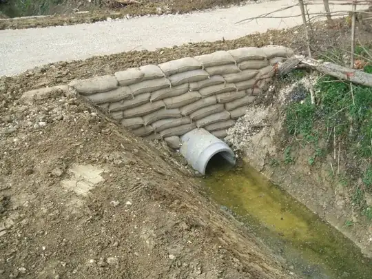

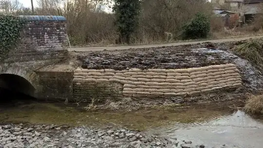

Legal issues aside (that's not our pigeon here), a reliable way is dry mix sand bagging:-
sandbags1 sandbags2
Pick a low quality concrete sans water, place it at your leisure and let the rain /moisture make it go off. It's a common civil engineering technique, and very efficient in terms of cost, effort and design experience. It also requires very little ground preparation, which for gabions can be quite some effort as the're regular shapes. Eventually the bags rot away and the concrete remains.
There's a (UK) supplier's fact sheet here, where the bags come pre-filled on a pallet.

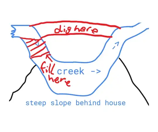

Without reference to the legal situation, just in practical terms... excavate a new channel for the water and build a dam stopping it coming your way. If you make the channel concave towards your side, it's more likely to meander away because water flows fastest on the outside of the bend and causes more erosion on that side, while depositing on the inside of the bend.
In terms of a material / engineering solution - you might want to look into Gabions. Wire cages you can fill with rocks.
