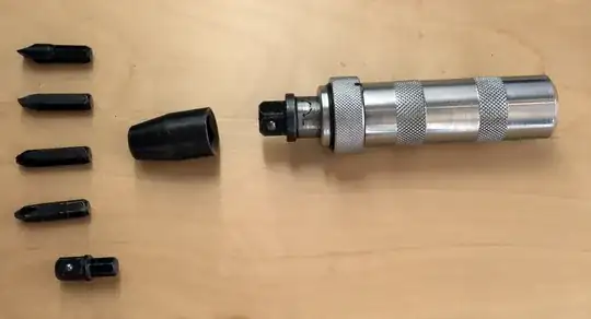

Impact Driver
For really stuck screws, you can use a manual impact driver.
  • Attach a bit that fits snugly in the screw slot
  • Set the driver to spin in the proper direction (this process varies from tool to tool, but most commonly, you'll compress the driver and twist).
  • Place the driver on the screw, and hold the driver as straight as possible (keep you hands away from both ends of the tool).
  • Give the back side of the driver a whack with a hammer (a rubber mallet or non-marring hammer is good for this).
  • Repeat until the screw starts to twist (most impact drivers have to be "reset" between strikes, so don't forget to reset the driver before whacking it again).
  • Once the screw is freed up, use a regular screwdriver to remove it.
This may not always be the best tool when working with sensitive electronics or delicate equipment, but it's very useful for removing stuck screws.

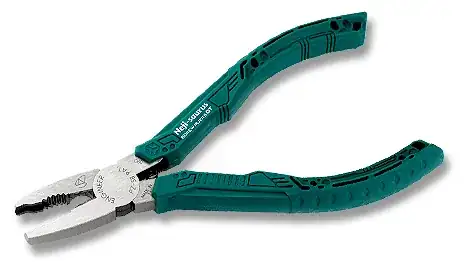

You could try the Screw Removal Pliers GT (Neji-Saurus), by Engineer Inc.. I'd like to buy a set myself.
