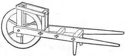

Basic wooden wheelbarrow frame
This is an illustration of a wood-framed (and probably wheeled, but swap that for a bicycle wheel) "bare-bones" form from this translated article (I was just looking for a good, basic, not too modern wheelbarrow illustration. I haven't read the article in any detail):
https://spot.colorado.edu/~richtea/prints.html
How much load you have to lift at the handles varies as you move the load more over the wheel, while how stable it is varies with how low you can get it. If you can arrange your "pack" as two "panniers" you can get it right over the wheel while keeping it low, by having it to the sides of the wheel. You still have to push or pull the weight, but you don't have to lift it. Still, on many of my local trails, you'd likely come to regret having to get it over rocks & trees (even with a large wheel) but your local trails may be more developed or involve fewer stair-stepped steep sections. It could also skid sideways on wet rock.
