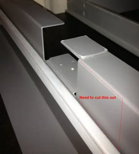

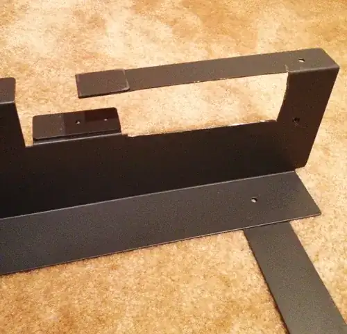

Will someone at Home Depot or Lowe's be able to cut this for me? If not, what tool should I buy and use?
Edit

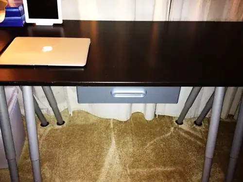

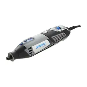

Thanks for all the help! I ended up buying a Dremel. I went through 6 cut-off wheels in order to finish all my cuts. I was customizing an IKEA drawer to fit under my smaller IKEA table. Here is one of my noob cuts:
And here is the finished product:

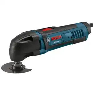

Oscillating multi-tool or Rotary tool
You're probably not cutting 1/8" steel with this, but it's useful for cutting very thin metal.
Multi-tool Rotary tool

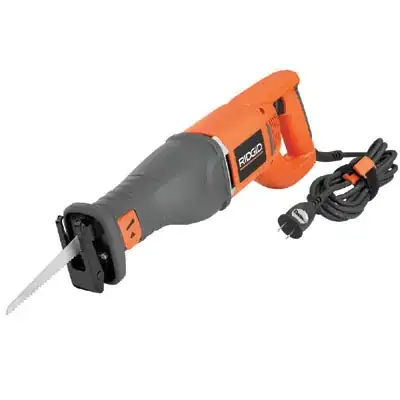

Reciprocating saw
More fun, but you may have trouble keeping a straight line.

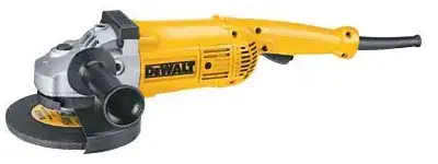

Angle grinder
Let the sparks fly! Lots of fun, and it will allow you to plunge cut.

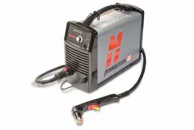

Torch
An Oxy-Acetylene, or Plasma torch will make short work of this job.

Is this aluminum channel, or is it steel? Will a magnet stick to it? This is important to know, since that would influence my choice of tools. A magnet will stick to steel. (I'm pretty confident this is not stainless steel from the looks of it, but I might be wrong. If so, then a magnet will not stick to some grades of stainless. And stainless offers some difficulties of its own for a novice to cut.) This looks like a steel doorframe channel.
For example, on steel, I'd go with an angle grinder as the fastest way to make the cuts, and a way to make a fairly straight cut. But aluminum would gum up the cutoff wheel.
For aluminum, I'd choose an oscillating multitool, like that from Porter Cable, Dremel, Fein, Bosch, etc. These tools take a toothed blade that oscillates rapidly, and will cut through aluminum easily. Again, you will get a fairly straight cut with the proper choice of cutting blade.
Lacking either of these tools, or being unwilling to buy one, I'd go with a hacksaw, which can cut either metal. Of course, a hacksaw will yield a somewhat jagged cut unless you have some practice here.
One problem with the cut will be in minimizing any vibrations of the metal as it is being cut. A jigsaw, or oscillating multitool, or hacksaw will all cause the material to bounce around. A good vise will help solve this. In fact, my preference would be to clamp a piece of sacrificial wood inside the channel, then put it all in a vise. That will yield the best and most vibration free (therefore cleanest) cut possible.
In any event, I'd expect to need to clean up the edges, rounding them so there are no sharp edges. A file will do for a start, then I'd switch to some emory paper. (Ok, sandpaper in a pinch.)
If the material is steel, make sure you paint the surface afterwards with a rust inhibitor, as the cut edges will rust otherwise.
I personally would use an angle grinder because it's a lot easier to keep a straight line. That, and you can use the same tool to clean the burrs off after. However, they're more dangerous than a jigsaw. You could always start out with a dremel and a few cutoff wheels.
I mentioned burrs above. Since it looks like you've never cut metal before, be aware that after you cut the surface will be very rough and sharp. You'll want to file or grind down the surface to make it safe.
