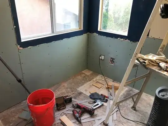

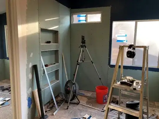

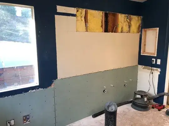

I am remodeling a bathroom that was originally done with 1/2 inch drywall. I opened-up the walls to move plumbing and electrical as required and then covered-up those sections with new 1/2 inch drywall.
The shower and tub areas are going to have tile on the walls as well as the entire bathroom floor. I've already done Ditra + tile in other rooms so no questions there.

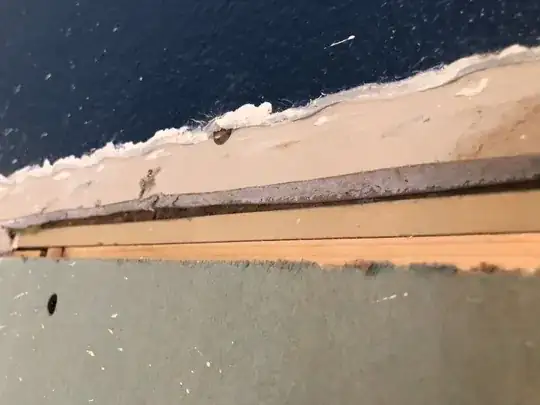

Here's my problem: Whoever built this room put on a skim coat that is, by the looks of it, about 1/8 of an inch thick in some areas. So my new drywall is 1/8 thinner than the existing wall in some sections and a perfect match in others.
Now I have the problem of matching all of this up before installing the Kerdi membrane.
What type of mud do I use for this? Is a general purpose compound good? Remember that I will have to apply unmodified thinset over it in certain areas in order to adhere the Kerdi membrane.

Is a 1/8 skim coat strong enough to support the tiles? I have no clue how well these layers will bond to each other.

Thick mud layer
Shower corner
Tub corner
Vanity corner

I don't think you'll need anything other than regular joint compound here. I would make sure you buy the widest trowel you can afford and simply work as much compound as possible to level the wall. Your kerdi board placed over the top (when used with the proper thinset) will block the water from reaching this layer.
