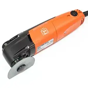

(Adding Fein Multimaster picture, see comment below)
