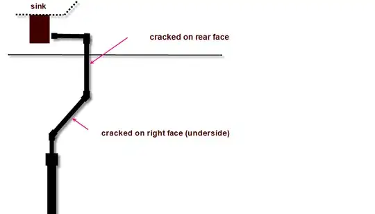

The 1-1/2" copper waste pipe than runs from our kitchen just up and cracked two days ago along its length, and for no apparent reason.
The crack is in a section of pipe that runs vertically through the kitchen floor down into the basement, where it connects to an angled length of pipe (two 45-degree elbows) and then a section of pipe that connects to cast iron sewer pipe (lead and oakum seal).
diagram
I would venture to say that this cracked pipe is from the 1970s (when former owners remodeled the kitchen) and that the section of copper pipe (which didn't crack) going into the cast iron hub dates from around 1948-49, when the house was built.
Could the crack have been the result of twisting forces when the pipe connection was made to the garbage disposal beneath the sink? Or does copper waste pipe just eventually give out, perhaps because of corrosion over a period of 50 years?

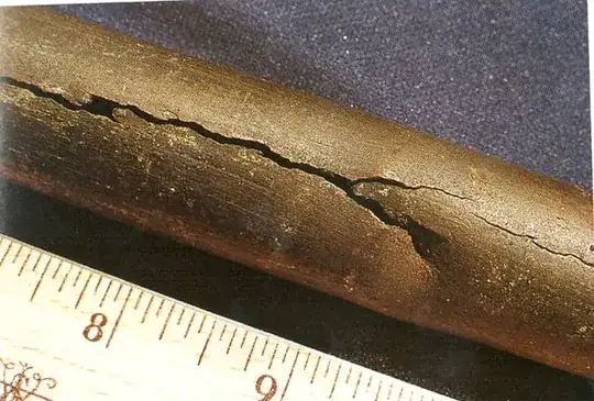

Typical "natural" cracks look like:
   expensive and stiff "sprinkler hose"
Possible ways it could have formed:
  • There was a defect/contamination in the extrusion die for that batch of pipe, propagating weakness down the length of pipe as it was extruded.
  • The pipe was rolled rather than extruded and then poorly joined (trying to make it look seamless).
  • Something/someone else uniformly scored the length of the pipe before it was installed.
Then after some years of thermal cycles and possibly mild corrosion, a crack formed and rapidly propagated along the rest of the weak line.

Copper does erode over time through mechanical wear and chemical corrosion. My guess is that it simply got thin enough that thermal stresses popped the weld (or the extrusion resulted in a thin side, causing a very straight crack).

It looks like it was thinned by corrosion until any stress opened it. Ammonia and it's compounds are notorious for attacking copper alloys ; Ammonia cracks brass not copper, but corrodes copper quickly. Maybe a previous owner liked to use ammonia for cleaning in the sink. That is why brass flex-tubes are not permitted for gas service, ammonia cleaners are common in kitchens and utility rooms and they will stress corrosion crack brasses rapidly. The answer is still replace with plastic.

My vote is a defect in the forming die caused a stress concentration. Stress corrosion cracking appeared here from residual built-in forming stresses. A corrosive environment and the residual forming stress propagated the crack along said stress concentration.
Was there evidence that the crack had been growing for a long time (mold or similar at/around the failed location)? The fact that two different pipe sections (likely cut from the same "mother" pipe) failed in similar fashions would, in my opinion, point to something not really dependent on the part's stress environment (other than the built in forming stress), since that external load would cause different stresses at different locations in the pipe.
