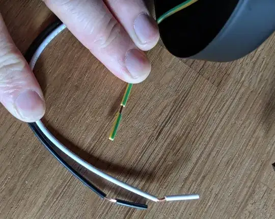

I recently bought a new light fitting off amazon.co.uk which has come with wiring as shown in the picture:
Wiring of light
I'm surprised to see black/white cabling since I thought this to be the US colour coding. The listing on Amazon claims
Compatible with world wide voltage - 110V or 240V and everything in between - please make use appropriate voltage of light bulb

The wires
If you find a proper UL listing or equivalent, then you can install it. Due to treaties, a CSA listing on a US product is honored in the EU. (again CE isn't anything, but a TUV listing from a German product is honored in the US). So it's not uncommon to find EU color codes (brown/blue) in the US or US color codes (black/white) in the EU.
Black is hot and should be taped brown (not critical).
White is neutral and should be taped light blue.

So green / yellow is earth.
You can put the black to live (aka phase) and the white to neutral (based on the comment by Dan D below). You could satisfy yourself by using a multimeter to check for continuity as appropriate.
If you are still unsure, then employ the services of a qualified electrician.
As for labelling, there may be some inside the product.

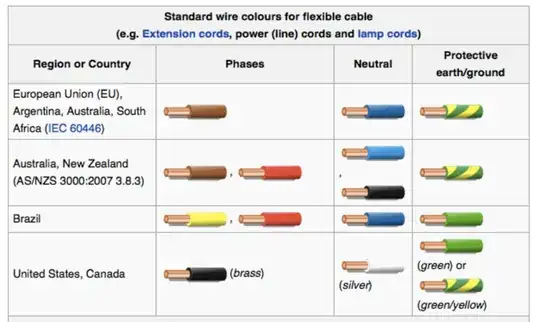

For wiring colors, they vary around the world and can be seen here :
This is just for flexible cable, the chart continues for fixed cables etc, just follow the link.
wiring colors
