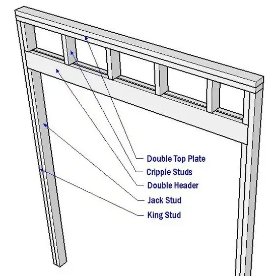

We purchased a very expensive (at least for us 5,000+) entry door pair as replacement for an existing single door and sidelights. Today when the door contractor came to install the doors the opening was too small by 3/4 of an inch (the door contractor had measured for the doors prior to purchasing, these were custom made doors and are fiberglass that look like wood with full light beveled glass).
They suggested removing or cutting down the jack studs. I am not comfortable with this. Is this a good solution? This is a load bearing wall. I have postponed installation to research this. Advice?

The king studs are the primary support on the sides of the door (they go all the way up to the top plate. However, the jack studs are supporting the header over the door and that is supporting the cripple studs over the header. If this is a load bearing wall, these are all supporting members.
doorframing
If the jack studs are cut down, they probably need to be cut more than 3/4 inch total to accomodate shims to square the door in the opening. If you take out only 1/2 inch on each side, you have reduced the jack stud by 33%. If this is done in place, you are also stressing the remaining structure of studs, header, etc. in sawing out the excess.
It could be that the overall framing is overengineered enough to survive this assualt, but it is risky, violates most building codes and is a bad way to start a good project.

Don't to it! Somebody made a mistake and it wasn't you, don't let the contractor take the easy way out at the expense of weakening your home's structure!
It may be that the contractor measured wrong, or put the wrong measurements in the order. It could also be that the order was right but were manufactured wrong, or you were sent someone else's doors! Insist on getting a copy of the order from your contractor. If they ordered correctly then the manufacturer is at fault and should replace the doors with the right ones. If your contractor measured or ordered wrong then they are negligent and should order a replacement. If you let them weaken the structure of your home in order to let someone off the hook and make their lives easier the only loser is you!

It's easy to say they mis-measured, make 'em fix it. That's not everyone's reality. There are alternatives that may be preferable to someone (not you!) buying a new door. Hacking the jack studs with a sawzall is NOT a viable alternative, as everyone has said.
You could re-frame the entire opening with a longer header. Or you could remove the jack studs and install metal beam hangers in their place, but additional king studs would possibly have to be installed to maintain adequate support, so this is almost as much work as a longer header. It may be possible to engineer an adequate jack stud support using thinner LVLs. I like this last idea, but not sure it will really work.
Ensure this is a bearing wall. Things are much easier if it's non-bearing.

I do framing work, some time people in this line of work make mistakes. In this situation I re-frame the opening and do the job right. I usually don't make any money on this type of job but I will get a good customer.
