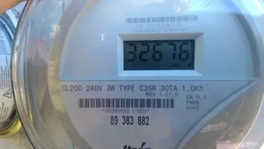

I would like to know how to understand my digital home electrical meter.
This picture shows what my home meter CURRENTLY reads. I intend to unplug everything in my tiny apartment in order to get another read.
My reason?
My apartment consists of 1 SINGLE room, a kitchen, and a TINY Bathroom. That's it. Nothing else. Yet my electric bill is upwards of 370.00 a month. I calculated it should be no more than 190 at its highest possible amount. I believe my downstairs neighbors might be using electric (unknowingly) from my electrical supply.
Photo of digital meter displaying 32676

They're kilowatt-hours. If you use 1000 watts for 1 hour, it'll add one to the current number displayed.
It's like an odometer on your car. It only counts up, and will never be at 0 except when it was brand new.

There's a web page which describes how to read instantaneous current through an Itron meter. The meter model there is not the same model as in your picture, but they appear to be from the same family and are likely to display similarly. In a nutshell it says this: the three squares in the lower right corner of the display show an animation corresponding to power consumption. Each time one of these squares changes light to dark or dark to light it represents 1 Wh consumed.
It stands to reason that you could turn off or disconnect everything in your apartment and then watch these squares on the meter for several minutes to see whether power is still being consumed. If it is, start turning off breakers until you identify the circuit where the power draw happens. Then evaluate whether you can make do with that circuit left permanently turned off.
The photo seems to show another meter to the left of the one pictured. How did you determine which meter is yours? I assume they're labeled by address or unit number. Your electric bill may have the meter number printed on it. I suggest you confirm the number on the bill matches the number on the meter face -- or whether it matches one of the other meters instead.
When you do the power consumption test watch the animation on the other meters too. If the "wrong" meter shows zero power consumption, or if you're not able to match up numbers between your bill and the meter you believe is yours, then call the utility and ask for their help in confirming that your account is paying for consumption on the correct meter. I imagine it's a rare thing for the billing to get crossed, but it must not be impossible.

It looks like other answers so far have given good tips, but haven't answered the question "How to read the meter" very well.
You could measure the power usage like this:
  1. Take a note of the current reading, e.g. 32676 kWh in your photo.
  2. Wait one hour.
  3. Take a note of the new reading, it could be e.g. 32679 kWh.
  4. Subtract the two values and you'll get the usage in kilowatt hours. E.g. 32679 kWh - 32676 kWh = 3 kWh. Because the time was 1 hour, this means average usage was 3 kW during this period.
But there is a severe limit on accuracy here: a small home might only use about 0.5 kW on average. So you wouldn't see if you have a small amount of extra usage, but a huge amount would be visible. You could get more accuracy by waiting for e.g. 10 hours, but I doubt you want to leave your fridge off for 10 hours.
You can check how many kWh you were billed for in your invoice. Divide that by the number of hours in the billing period and you'll know how many kW the electric company says you are using on average. For example, if your bill for 1.4.2019 to 31.4.2019 is 400 kWh, you'd calculate 400 kWh / (31 days * 24 hours) = 0.54 kW average usage.
You can then compare that average usage to your set of appliances. For example this site has many of the common appliances listed.

What is that power?
The big number is like an odometer - it is not instant demand (like speed on a car), it is total usage (odometer).
The little 3 squares on the lower right keep changing. 1000 little changes = 1 big number. You can guesstimate how much you use by timing out how many changes in 3.6 seconds (or 36 seconds and divide by 10) - that tells you how many kilowatts you are using at that point.
Kilowatt is a "rate of speed" - how much energy you are using right now.
The "odometer" measures how much energy you have used in the past - exactly what they want for billing. The unit is "kilowatt-hour" or 1 kilowatt for 1 hour.
An average house uses around 1.0 kilowatts averaged 24x7 (much more by day, much less at night). It sounds like your house uses an average of 3-5 kilowatts, which is an average of 12-20 amps at 240V, or 24-40 amps at 120V. Again much more by day, much less by night.
