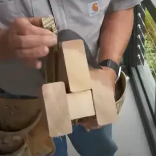

This Old House TV // Jamestown Net-Zero House // Episode 11 just covered this last season. Silva's solution are typically simple and ingenious.
https://youtu.be/dfIWRhbCcNA?t=865
Silva creates a groove by the framing design, then creates a mating piece that serves to hold the screen in place, and also easy to remove and replace.
This solution in the video is the result of the framing construction, but the method could be applied to any screened porch, especially if the window frames are made of wood. Cutting a dado in each sash, then a mating piece with a matching rabbet would allow you to create tension in the screen while you push and secure this mating piece in.
