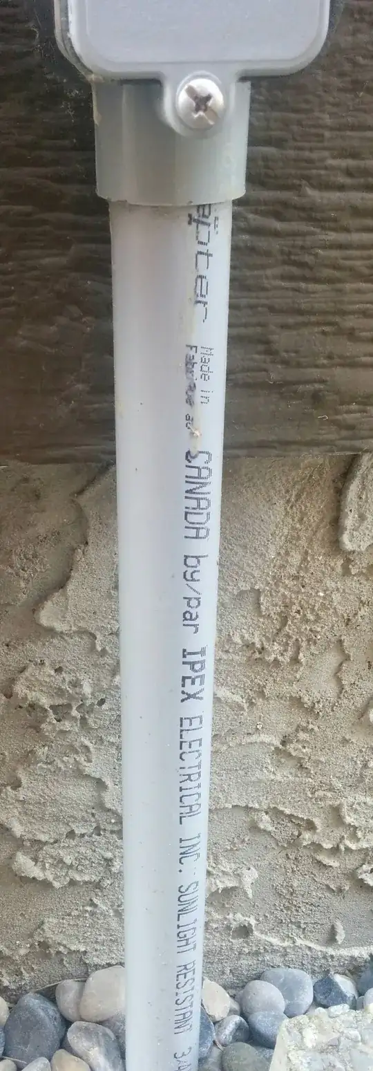

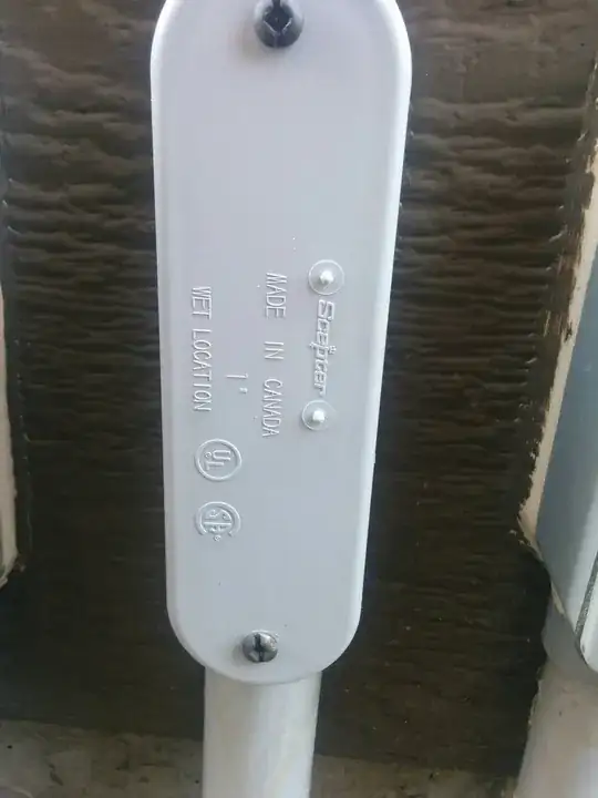

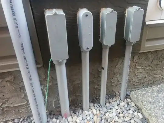

What are the four boxes in the picture below for? The fat pipe to the left goes up to the electricity meter. I've also included pictures of the two labels I could find.
Also, why is there a green plastic rope coming out of the first box? I found the box slightly gaping with the bottom screw missing1, and the rubber water seal around the cover a bit ripped where the rope is coming from. When I pull on the rope, there seems to be no resistance as if I could completely pull it out of the box. The fact that the seal is cut up where the rope is makes me think it wasn't supposed to be there in the first place...Should I pull out the rope and fix the seal of the box's cover?
1 I placed a new screw as seen in the picture, so that the box isn't gaping wide open (to rain, insects, etc.)...

That is non metallic (PVC) electrical conduit.
There must be wires in them that come from or go to the inside of the house to an out building or ?? .
The green cord could be left there for fishing ( pulling ) new wire from one of the ends. Have you seen this green cord near any other electrical fixtures?
The covers come off to facilitate fishing the wires, It can be difficult to fish the wires thru many bends, so with this setup, you can pull a length of wire from one direction thru the open body and then pull the remainder as you help feed in to the body to complete the turn, then put the cover back on.

These are conduit bodies
What you are looking at is a set of PVC electrical conduits that extend underground (maybe to outbuildings or such?) with wiring inside, as well as at least one pull rope (the green rope you see dangling outside one of them) that can be used to add more wire to that conduit.
Attached to these conduits coming out of the ground are LB conduit bodies that provide a means of making the tight bend into the wall that's still accessible, so the electrician can make the pull through the underground conduit up to the open body, as the covers come off, then finish the pull from the body to the panel or box the conduit terminates at. This is done as the pulling forces become excessive if a wire pull becomes too long or bendy; the NEC sets a limit of 360° of cumulative bend between pull points for this reason, for that matter.
ThreePhaseEel
  • 87,685
  • 144
  • 243
First, get a nice strong magnet and pick through gravel below for that missing screw.
Regardless, take that cover off and bring it to a few local electrical supply houses (NOT big-box stores) and see if any of them sell that same PVC conduit body. They may be able to sell you a cover, but which brands they carry will vary. Obviously you want one that carries that brand of conduit body, so call ahead. It was a huge mistake to leave that rope dangling out of the gasket, as it wrecked the gasket.
The rope is in there for future pulling. Most people's tendency is to assume "the last person" was a fool. My rule is assume the last person did that thing for a reason, and you just haven't caught up with the reason yet. At some point in the future you will want something, and with any luck it'll be related and voila.
Expect that aged rope to be flimsy as heck. It will have been sitting in water for years. Don't pull wires with it - pull a new rope similar to it, then use that to pull the wires. The water isn't because of the missing screw. The water is because all underground wiring is 100% under water 100% of the time no matter how much we try to seal it, or that's the assumption we make. Trying to make conduit actually watertight is a lost cause, unless you go to industrial extremes like pressurizing it to 2 PSI. And there's no reason to bother; wet-rated wire such as THWN-2 or XHHW is rated for 100% water contact.
Also by the way, don't use cables in conduit. It's legal, just unnecessarily difficult. Use individual wires (that are wet-rated such as THWN-2 or XHHW). Besides, NM/Romex isn't wet rated).
Lastly, if that conduit is anything other than a northern exposure, paint it otherwise UV damage will tear it up. 1) Lightly sand it with a green Scotchbrite pad so the primer will stick, 2) brush an alkyd primer like Kilz Original or Rustoleum 7780 (use an 80 cent cheapie natural bristle brush, it won't clean with water, just throw it away), give it a month to cure, then 3) top with your house's latex paint.
