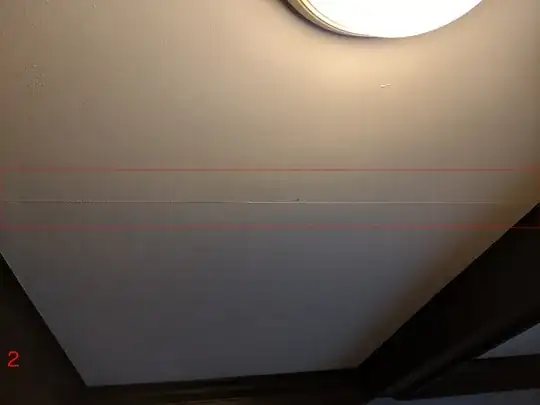

They also paneled the kitchen ceiling, which I now think was to cover up all the damage the ceiling might have. I had asked them about the paneling, because I assumed that is why they put paneling, to cover some water damage. They just told me they wanted a country look.d

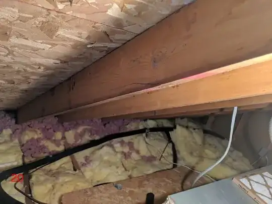

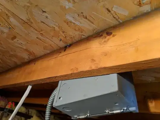

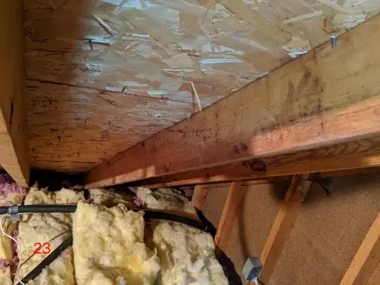

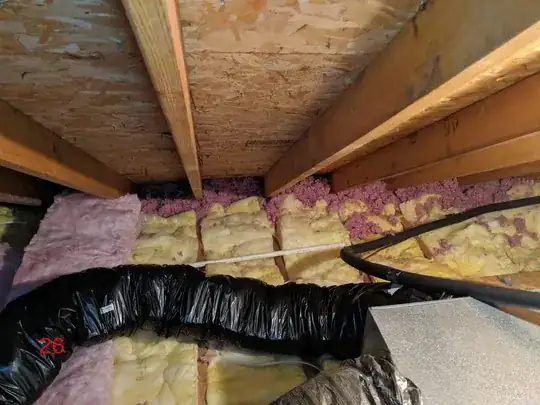

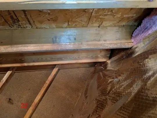

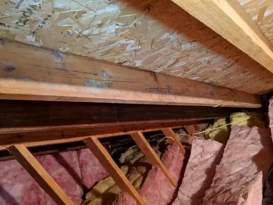

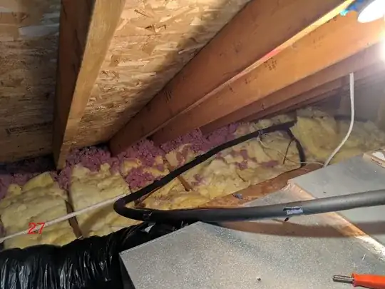

There are a couple rafters, at least that I can see, that have been repaired, and a couple other cracked ones. I think one is getting worse, or at least worse than when I had the house inspected.

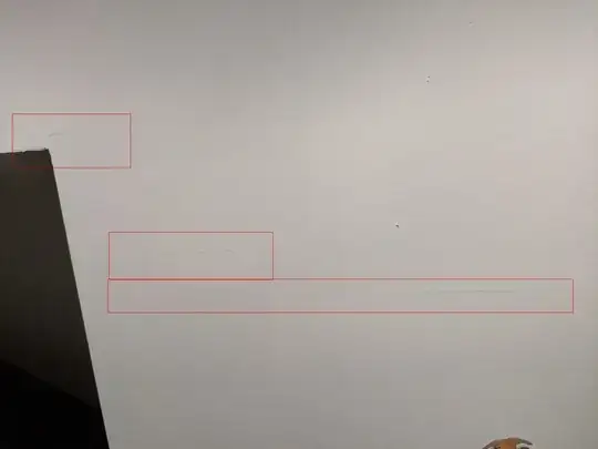

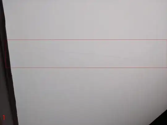

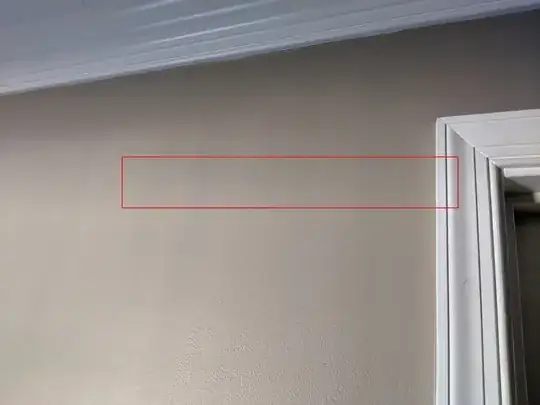

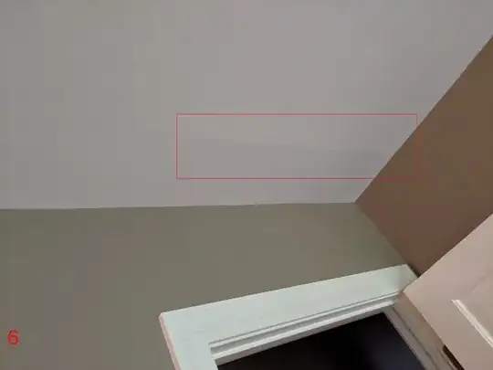

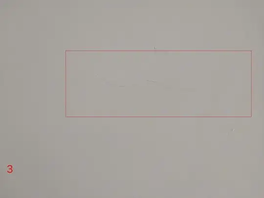

enter image description here enter image description here Picture one and two is the ceiling of a bedroom. I think that one happened when I went up into the attic over the garage. The garage attic spans the garage and this room. I can feel the floor sag when I walk over it.

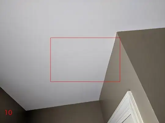

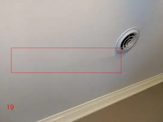

enter image description here Picture three is (I guess) the living room ceiling. This room has an odd bulge starting at the entrance. Above this room is some weird room with no closet. When I walk in that room there's lots of cracking/creaking noises on the side that is near the stairs that come up to the second floor and the one that goes up to the attic...attic entrance is in this room.

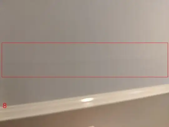

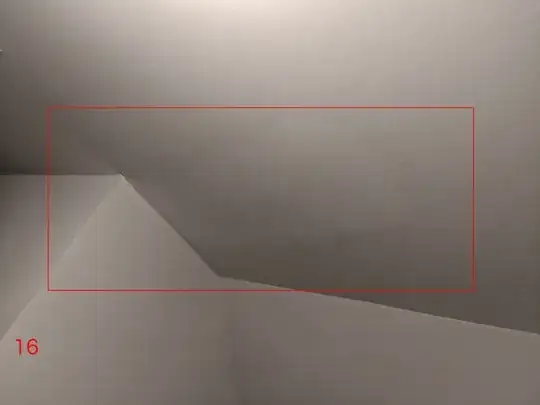

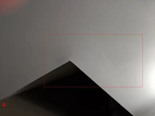

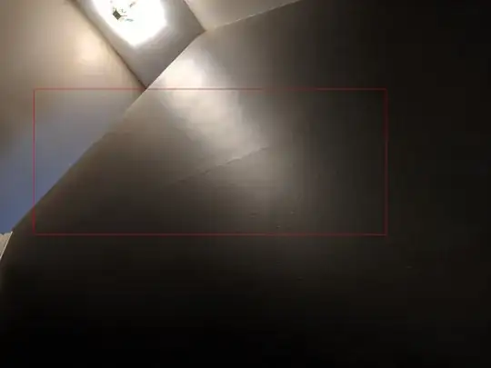

enter image description here enter image description here Picture four is of the stairway, just as I'm about to go upstairs. The stairs seem to be sinking. Picture 17 shows the bulge in the floor and how much of a dip there is around the stairs.

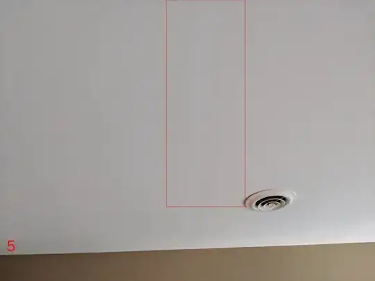

enter image description here Picture 5 is of a bedroom. It's hard to see in the picture but there is a crease starting to show in the sheet rock. A lot the cracks I see around the house start like this. They start as a faint crease then start getting more defined until they turn into a crack. The vent near the crease is also starting to pop out. Above this room is the attic, which the previous owners finished off. There's lots of popping and cracking going on when I walk around up there. As well as a sagging feeling, as if the floor goes down a bit when I walk over it. This could just be the plywood sagging, but the creases in the sheet rock and vents popping out make me think it's something else.

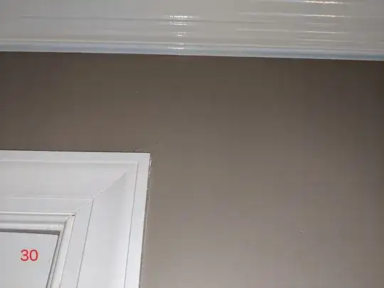

enter image description here Picture 6 is the same room as 5. Off to the right of this pic right out side the door is the stairway. You can see the bulging starting here too.
enter image description here Picture 7 is the ceiling of that odd room above the living room I mentioned earlier. There's a lot of nail pops a long the wall. And other spots. There's lots of nail pops all over the house actually.

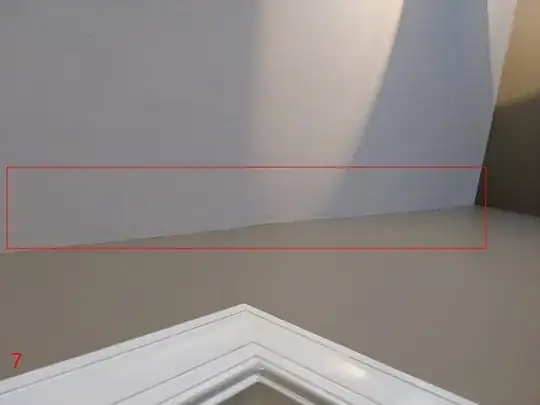

enter image description here Picture 8 is another crease, hard to see, but in a bedroom. It's been getting longer.

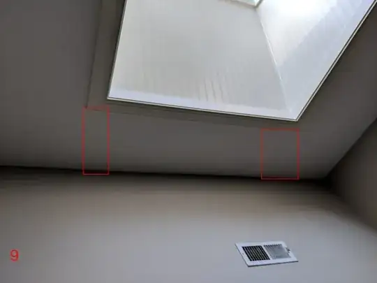

enter image description here The skylight in the master bedroom has cracks coming out from the corners of it. The entrance this bathroom has a diagonal crack at the edge of the door which was patched and is hard to see. It doesn't look like it's getting worse. What's strange is that a door in the wall perpendicular to this wall (closet door) also has a diagonal crack. It was also patched and I don't see it getting worse.

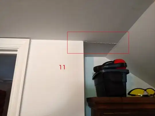

enter image description here Picture 11 is a room in the attic. Again, like all these cracks, were not there the times I viewed the house. Also, a lot of these cracks were patched at one point.

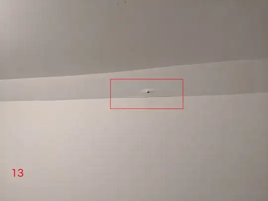

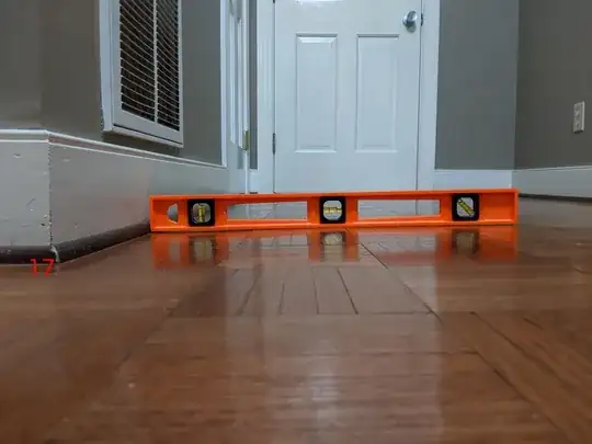

enter image description here Picture 13 is a really strange one. One day I had heard a loud crack/tearing sound. I looked around the house but didn't see anything that could have made that sound, and I didn't head up to the attic (it was at night). The next day after work I had gone up the attic and saw this new buckle point. I stuck a nail through it so I could find it when I went to the other side of the wall. I was expecting to find a beam or something pushing against this spot, but there was nothing.

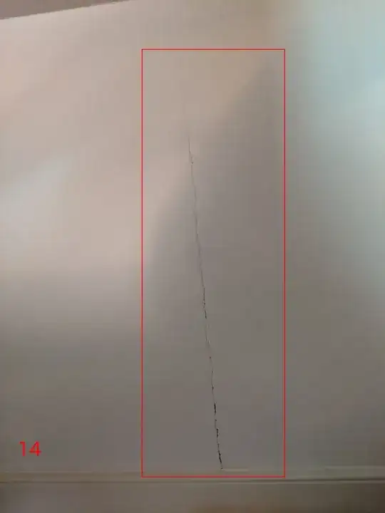

enter image description here Picture 14 is another crack in the attic that never existed when I first viewed the house. It started as a crease looking line and has grown to what you see.

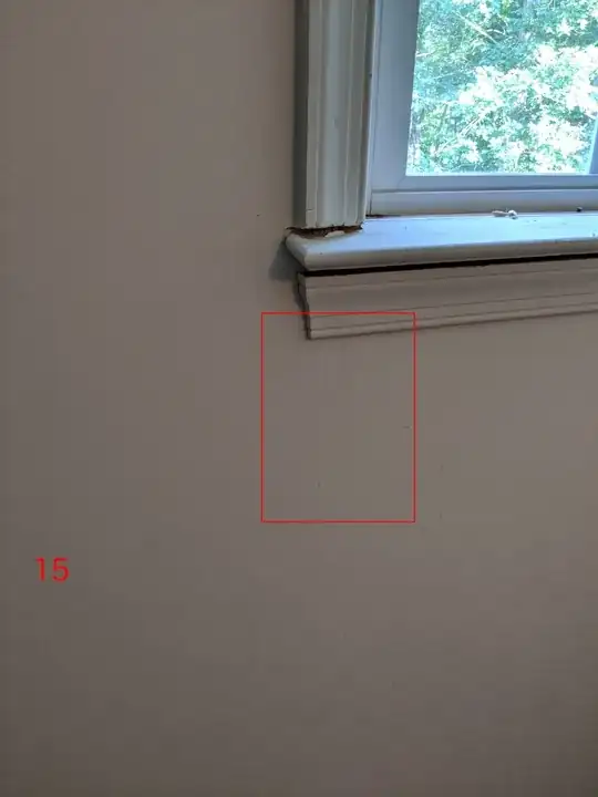

enter image description here Cracks below an attic window cill. I think the broken window frame is from them putting an AC in the window. Both attic window frames have this same damage.

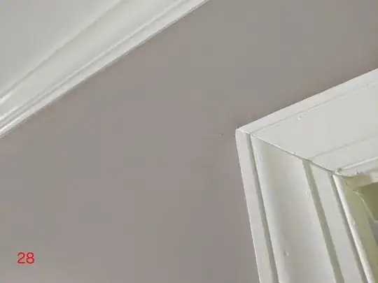

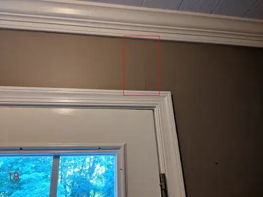

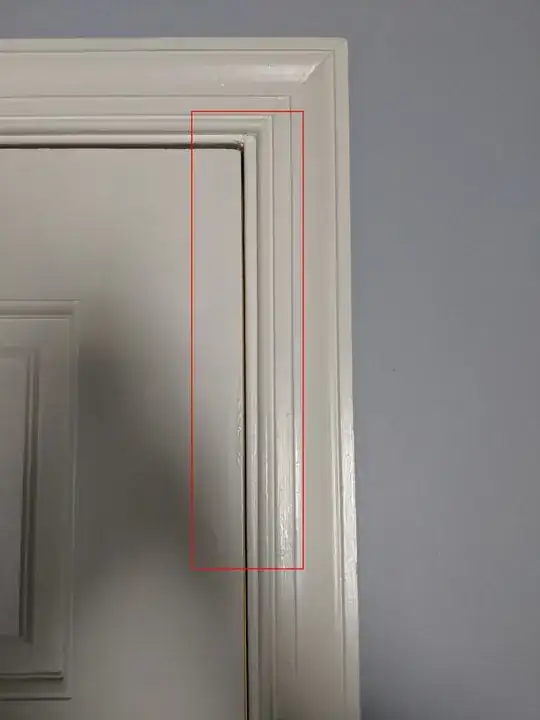

enter image description here Picture 18 is a door near the garage. Another new crack.

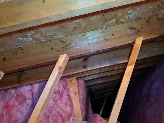

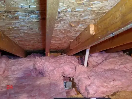

enter image description here enter image description here Pictures 24 and 25 are a couple of the repaired rafters.
enter image description here enter image description here Pictures 26 and 27 are just to show the spacing of the rafters, I guess I should have held a ruler up...

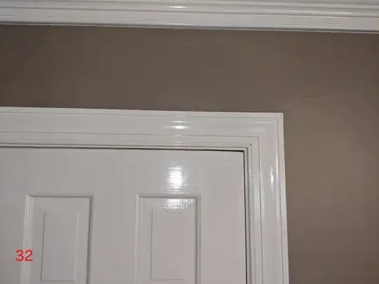

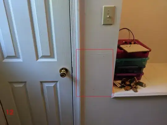

enter image description here enter image description here enter image description here These pictures are the entrance to the mater bedroom closet. There's an entrance from the master bedroom room, and an entrance from another room. The doorway walls are perpendicular to each other.

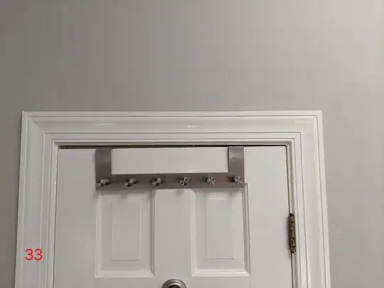

enter image description here Master bathroom door from the inside. If you look closely at the right corner you can see that it looks like a crack was covered up. Also the door is not even, and does not shut, pin does no line up with the hole. This wall is also perpendicular to picture #30, the master closet door.
Hard to draw, but these are the directions of the cracks. Down arrow is entrance to the master bedroom closet from another room. The arrows are the directions of the cracks.

left side of stairway Right side of stairway These two pictures show those creases now showing up in the stairwell. It's between the two floors.
ceiling by stairwell Here's an update of picture 4. Same spot getting worse.

The rafters look fine. They are straight, showing no signs of sagging or stress. The cracks that you point out are the usual lumber "checks" that appear as the wood dries. The checks have little structural impact and are accounted for by architects and material specifiers.
The floor movement and wall board cracks are not unusual in many older homes. The footings, if there are any under the foundation walls, probably could have been wider. If they are not deep enough the building will move with the freeze-thaw cycles.
If it were my house I would accept the floors as part of the building's character.
I would also become an expert wall board re-finisher, especially with the newer fiberglass tapes and synthetic "mud" that offer some flexibility, accommodating building movement with little or no cracking. Generally the cracks appear at seams, and repairs with improved flexible materials can last for decades. Inside corners, like wall-to-ceiling, can be cleaned up and re-seamed with long-life flexible caulk instead of the traditional paper tape and clay mud. The traditional method of drywall finish is done because it is cheap. It is very poor at withstanding any building movement.
I covered one troublesome ceiling with 3/8 inch plywood and finished it with fiberglass tape and flexible auto body Bondo. It never cracked again, even with the inadequate ceiling/floor joists flexing from the foot traffic overhead.
Unfortunately, home-builders a century ago didn't have the hindsight that contemporary builders do. Enjoying the character of a century old home usually comes with some building performance compromise. Most buildings move a little. Some places are more active or show the movement more than others. Stucco buildings, for example, are notorious for revealing movement.
Enjoy your classic looking home.

I see a couple different things.
The attic that was finished may not have large enough or close enough joists to support heavy loads or walking (e.g. 2x4 on 24" center), letting them flex and crack the ceiling below. This spacing may also be repeated in the rafters. Another sign the rafters may be built to a bare minimum spec is your mention of "There are a couple rafters, at least that I can see, that have been repaired, and a couple other cracked ones. I think one is getting worse, or at least worse than when I had the house inspected."
If the rafters are on 24" centers and the attic was finished by simply nailing 2x4's between them to make the attic ceiling and knee walls (see the angled edge in pic 13), then wind, furniture, and live loads (e.g. walking in the attic) could flex the drywall up there enough to cause cracks as seen in pics 1, 2, 3, 5, 6, 10, 11, 13, 16, and maybe 19. It could also contribute to cracks around the skylights, like pic 9.
The cracks beneath the attic windows could be, as you said, from them hanging a window a/c unit. If the window framing isn't up to snuff, the weight cantilevered out the window could crack the drywall inside.
The many nail pops throughout the house look like someone didn't know how to do drywall properly. I'm far from an expert, but the simplest way I've seen to fix as many as you show in pic 7 is to lightly sand them down to level, then embed mesh tape over them, mud, sand and refinish the edges.
Cracks around doorways (e.g. pic 18) could be from the wall flexing as you open and close the door, especially if you close it firmly. I would guess the joint may not have been properly taped. Sanding it smooth, using mesh tape, and refinishing the joint may prevent re-cracking in the future. Others with more drywall experience may have better suggestions.
The bulge on the floor in pic 17 doesn't particularly alarm me, but your comment about "The stairs seem to be sinking. Picture 17 shows the bulge in the floor and how much of a dip there is around the stairs.", combined with the slope shown by the center bubble on the level, makes me wonder if the floor and stairs have moved since you moved in. If so, it would be worth opening the drywall at the top and bottom under the stairs to make sure they're correctly fastened.
You don't say where the crack in pic 14 is located, but the fact that it's wider at the bottom than the top, with your comments about pops, creaks, a "tearing sound", and the step crack in the brickwork make me wonder whether it may be settling (although I wouldn't expect much in a 33 year old house), or whether the foundation may be moving slightly.

It’s odd that there are discontinuous cracks throughout your house. This can be caused by 1) movement (settlement) is just beginning, or 2) just a few portions of your house are moving.
1) I googled “soil types in Virginia” and discovered that Virginia has a fair amount of clay in its soil. If this is the case, the house could be moving due to water expanding the soil.
I live where the soil is mush. When we build, we put the footings very deep or provide a different type of footing, like pilings or caissons. Perhaps your footings we’re not installed deep enough for expansive clay soils or for frost. If so, your footings could “heave” causing the house to move and crack your walls, brick by your door, etc.
2) I don’t understand where each crack has occurred, but if it’s located on the West end of your house, or only by the garage, etc. I’d think that that portion of your house could have footing issues, like shallow footings, undersized footings, etc.
I have testified in many cases where the buyer feels the seller “covered up” structural issues. In each case we documented what occurred. That is to say, we created a journal that documented the location, size (width and length), etc. with pictures. I’d number each crack and review each crack each week for a minimum of 6 months. If no changes, I’d switch to once every month for another 6 months. (You want to follow all the cracks’ progress for a minimum of 1 year...through all the seasons.)
I’d also check the depth of ALL your footings and compare them to your neighbors. I’d check with local contractors and Building Officials to see what is customary.
Next, I’d get an architect or structural engineer to check the widths of the footings compared to the actual load they carry. (This will be expensive, unless you have a set of blueprints. You can sketch up your own, but be careful to locate all interior footings too.)
