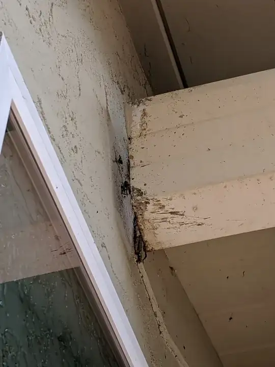

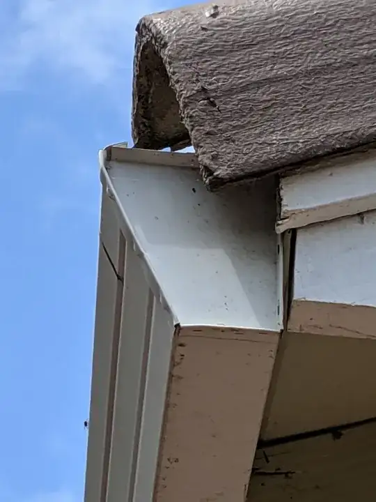

I have a fascia gutter with no endcap at all over a window. When it rains, water pours down over the Window which seems bad...
What I'm struggling with is locating an end cap to fit the gutter. Neither Home Depot nor Lowes sell one large enough. Are they normally handmade out of sheet metal, or am I just looking in the wrong places?
Missing cap Example cap

That doesn't look like a "standard" gutter shape anyways. I doubt you'd be able to buy something to fit natively anyways.
What you can try is buying some sheet metal and cutting it to size with tin snips, making fold points on the sides so you can secure it with stainless steel screws. Then you caulk it up good. It should buy you some more time until you replace the entire gutter system.
