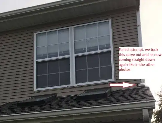

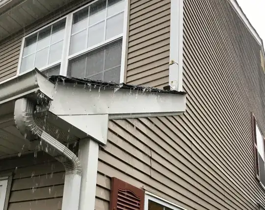

I have an upper roof downspout emptying onto a lower roof. the downspout exit sits near the side of the lower roof, and water falls off the side before continuing down to fall into the lower roof gutter.
is it possible to install a gutter along the side? is the only solution a downspout extension to the lower gutter? how is the downspout extension secured? We prefer the gutter along the side but can it be attached to the existing lower roof gutter? not sure what type of gutter corner that would require. i don't think we can send the upper roof downspout straight down to the ground due to association rules.
we have two skylights so we can't move the upper roof downspout towards the center of the roof because of how much water is directed out from the upper roof. We want to avoid a leak in the Skylights.
this roof is only about 10-12 feet long[![][2]]3

One solution I saw was a 45 bend on the top outlet which “threw” the water into the middle of the roof... worked well and cheap and easy...
